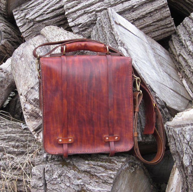

andyb Report post Posted March 4, 2012 (edited) I have made a few small projects (like a pocket watch holder to wear on a belt and some other very small items), but this is the first project I have ever attempted with more than a couple of dollars worth of leather. It came out exactly like I envisioned it, but my vision at this point is limited, since I am a leatherworking newbie. I really need to start learning how to do carving and stamping, as there are some beautiful examples posted here by others. I had the bag partially sewn, and decided it was too long, so I cut it apart and shortened it by a few inches. It didn't affect anything, just took me more time, and I ended up using the cutoffs as the strap guides and some other items, so none went to waste. It is Craftsman 8-9 oz veg tanned tooling leather from Tandy, and all hand stitched because I don't have a sewing machine that would work to do this. I still have to soften the leather a bit and use it to give it a bit more worn appearance, but it came out pretty good. The one tip I would be interested in, is how to soften the leather. I know veg tanned stuff isn't going to be as soft as other types, but any amount of softness would be good. EDIT: I forgot to add, one half of the shoulder strap is a section of military sling. I liked how the hooks for adjusting the length worked, so I used the sling instead of pulling the hooks off of it. Andy B. Edited March 4, 2012 by andyb Quote Share this post Link to post Share on other sites
benlilly1 Report post Posted March 5, 2012 Nice looking bag....I especially like the hooks. Quote Share this post Link to post Share on other sites
NoahL Report post Posted March 5, 2012 That looks very nice! I really like the hooks, too! As for softening it up, just use a little extra virgin olive oil, mink oil or neatsfoot oil and work it into the leather and you should find that it softens up and becomes more pliable. Quote Share this post Link to post Share on other sites
Mijo Report post Posted March 5, 2012 really nice, particularly since it's your first. Quote Share this post Link to post Share on other sites
Suicide Report post Posted March 5, 2012 Wow! Thats great! Agreed on hooks Quote Share this post Link to post Share on other sites
chancey77 Report post Posted March 5, 2012 (edited) Pelican hooks!!!!!!!!!!!! SWEET! Are those copper ones? I have only seen brass and nickel! Sailing shops have them, they are for lifelines...I get almost all my brass from sailing supply. Great idea! Very nice looking bag, just add some olive oil to that bag and it will be good to go:) Edited March 5, 2012 by chancey77 Quote Share this post Link to post Share on other sites
andyb Report post Posted March 6, 2012 Thanks for the positive comments! I definitely learned a lot about fitting and matching up stitch holes while doing this. I have never wet-molded anything, so that is something else I will try with one of my next projects. Yes, they are pelican hooks. Just plain brass ones. I saw them on a belt a few years ago and just thought they were the coolest type of "buckle", so had to use them. The down side to them is you can't use them with wide straps (at least I never saw them large enough to work), but that was fine for this project. The snap clips that hold the shoulder strap on were too narrow as it was and I ended up cutting the ends off and silver soldering on a wider rectangle to fit the shoulder strap. Andy B. Quote Share this post Link to post Share on other sites
ramrod Report post Posted March 6, 2012 very nice job! well done with the hardware, too. where do you get the pelican hooks? Quote Share this post Link to post Share on other sites
chancey77 Report post Posted March 6, 2012 Thanks for the positive comments! I definitely learned a lot about fitting and matching up stitch holes while doing this. I have never wet-molded anything, so that is something else I will try with one of my next projects. Yes, they are pelican hooks. Just plain brass ones. I saw them on a belt a few years ago and just thought they were the coolest type of "buckle", so had to use them. The down side to them is you can't use them with wide straps (at least I never saw them large enough to work), but that was fine for this project. The snap clips that hold the shoulder strap on were too narrow as it was and I ended up cutting the ends off and silver soldering on a wider rectangle to fit the shoulder strap. Andy B. That s a great mod Andy! Much respect for that! Cutting off the ends of the hooks and making it work, that is what it is all about! Pelicans are designed for ropes for lifelines so they are always round. In your picture they look copper, maybe just the way the light it hitting them. I love sailing and equipment and use pieces from boats all the time. I never thought about using them for latches (really kicking myself right now), I always use the big brass clips, but now you have me thinking. Thanks for the share, and keep up the great work! As far as tooling stamps and using a swivel knife go, you are in the right place to get tips and advise for that!!!!! Take some of the scraps the you have left over and give it w whirl...practice, practice, practice...If you are not sure what you need there is a place on the forum here about tools for beginners, and there are a lot of videos on Tandy's Web site, that should get you up and running before you know it. Stamps are all about consistency, the amount of force made to make the stamp last and repetition along with rhythm for things like backgrounders. Swivel knife work, best rule is to cut 1/2 the depth into the leather and bevel the knife cuts to make it from 2d to the glorious 3d that you are searching for. It seems you are not a novas when it comes to tools , so just like everything else work and tool related let your tools do the work they where designed to do, a hammer has different weights for a reason, let the hammers do their job no need to over work your arm:) I have 3 different weights depending on what I am using the stamps for. Looking forward to your next project:) Quote Share this post Link to post Share on other sites

andyb Report post Posted March 9, 2012 ramrod, I don't recall where I picked up the pelican hooks. I just did a search like chancey77 posted, only not for stainless. I paid somewhere around $5 or $6 apiece for them. chancey77, I've been reading the swivel knife and carving tips here. One of my problems was I thought you just barely cut into the leather. Now that I'd reading about cutting almost halfway in I am starting to understand how the 3D effect is created. I'm planning to start experimenting in the next week or two. Maybe this weekend if I have some time. Cheryl, I never thought of using Vaseline. I have Lexol conditioner and Obenauf's leather cream and conditioner, but they didn't seem to do much in the way of softening the leather. I've seen some folks recommend Neatsfoot oil, but I don't have any of that laying around. I may try the Vaseline. Andy B. Quote Share this post Link to post Share on other sites

quikjimmy Report post Posted March 9, 2012 Love the design and layout of the bag. All the proportions just work. Quote Share this post Link to post Share on other sites
WScott Report post Posted March 11, 2012 (edited) It is an awesome bag!! Amazing for a first bag. Love the attention to details and unique hardware used. Still working my skill level up to this, learning how to do better on smaller projects. Thanks for posting yours as I get to learn from you and the comments the project generates. Edited March 11, 2012 by WScott Quote Share this post Link to post Share on other sites
BLent87 Report post Posted February 28, 2013 I just picked up some of the craftsman leather from Tandy. Got it for $3/sq ft to use as practice leather. What did you use to stain your bag? I love the texture to it! Quote Share this post Link to post Share on other sites
