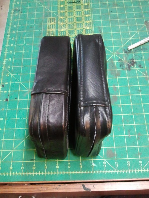

Here's another shot of the gusset with the stealthy zipper (the one on the left is the one I did, the right is the OEM pleather cover):

Hm...but it looks like the bag on the rightt has the front and the back gusset seams top stitched cause they both look like they lay flat. That's what I don't understand how to do. I would understand if only one side had this but once you put the second side on, how would you get the lay down stitch in there? Hope I'm making sense here.
Andrew
Sorry. Missed the part about the one on the right being the OEM one. I guess I wonder how they do that stitch.
Andrew
Andrew
Andrew
It likely done on a post bed machine, the lay down stitch would be on the side of the gusset for the second side sewn or like the OEM cover, the laydown stitch for both front and back is on the gusset.
A cylinder bed can't do the laydown for both pieces like that and a flat bed couldn't either...at least that I know of.
The zipper on the bottom is what makes it possible. Once you have the seam stitches in, simply open the zipper and sew the top stitch down through the opening (with a post bed as mentioned)
