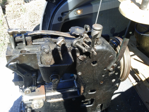

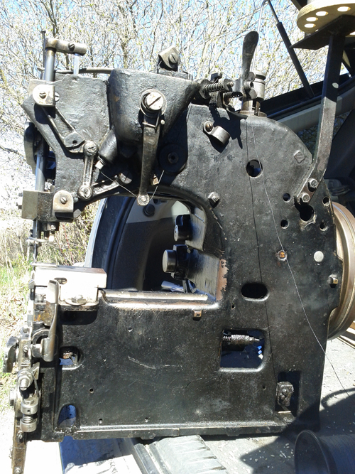

Members angelren Posted April 6, 2012 Members Report Posted April 6, 2012 Just got this champion sewing machine, oldie but a goodie. I am posting a few pics in hope that anyone that has one of these might notice any missing parts or out of alignment issues. I believe the awl is off center from the needle. If anyone has one of these guys running and sewing I appreciate any pics u can post. Quote
Members angelren Posted April 6, 2012 Author Members Report Posted April 6, 2012 Oh btw I took the bobbin out to show the internals Quote
dirtclod Posted April 6, 2012 Report Posted April 6, 2012 Looks to me like the needle is bent a little. Have you tried another needle ? Quote
Members bdt46 Posted April 6, 2012 Members Report Posted April 6, 2012 The needle is bent! I have owned a couple of these old machines over the years, and while needles and awls can still be found without toomuch trouble, parts are almost non existent! If they are not worn out and everything is correctly adjusted, these old machines will sew 3/4" of leather pretty easily. Good luck with the old girl, and hope everything works well. Quote
