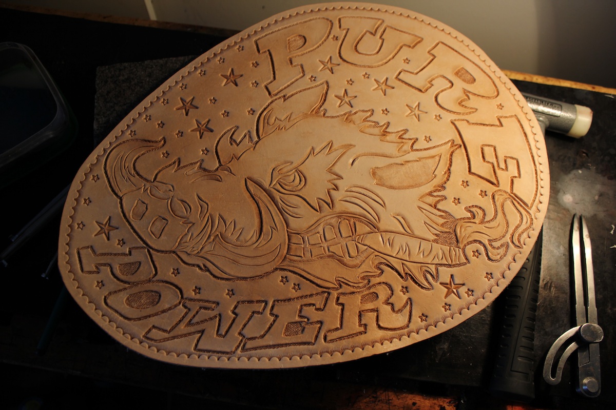

Members chancey77 Posted April 7, 2012 Members Report Posted April 7, 2012 (edited) PURE HOG POWER!!!!!!! HERE IS THE NEWEST SEAT FOR A NEWLY REBUILT OL' SHOVEL. BIKE IS STILL IN PAINT...UPLOAD PICS AS SOON AS THE BIKE IS DONE! LEATHER BOTTOM WICH I WILL GET PICS OF WHEN IT IS DONE, 19HR...FROM MAKING THE ORIGINAL DRAWING TO THE POINT IT IS NOW:) JUST NEED TO LACE IT UP AND CALL IT A DAY:) Edited April 7, 2012 by chancey77 Quote
Members Bluesman Posted April 7, 2012 Members Report Posted April 7, 2012 Great design and look Chancey. Cigar chompin' Hog, I like it. Say, what kind of pan are you using and also what do you use for padding? Quote
Members chancey77 Posted April 7, 2012 Author Members Report Posted April 7, 2012 Great design and look Chancey. Cigar chompin' Hog, I like it. Say, what kind of pan are you using and also what do you use for padding? My pans are custom made for each bike:) This one was handed to me by the owner.... I love it when that happens! Already made by him specifically for this frame...it is getting a hydraulic shock mount:) For padding I use a black closed cell foam. It is dense but it still has some bounce. It is about 1" THICK. They use the same stuff to insulate pipes in the far north for winter. I buy it by the Sq. Meter..60€per sq mtr. Quote

Members Cyberthrasher Posted April 8, 2012 Members Report Posted April 8, 2012 I need to find me an old beat up rigid seat to steal the pan out of. So, is that the only dye it's getting? Quote
Members ironhead13 Posted April 8, 2012 Members Report Posted April 8, 2012 That bold outline!!!!!!!!!!!!!!!!!!!!!!!!!!!!!!!!!!!!!!!!!!!!!!!!!!!!!!!!!!!!!!!!!!!!!!!!!!!!!!!! Cyberthrasher, You could always make one...? Not sure what your limited with tools, but getting creative and working with what you got is sometimes to cool part (or frustrating part) when it comes to metal. Quote
Members chancey77 Posted April 8, 2012 Author Members Report Posted April 8, 2012 (edited) I need to find me an old beat up rigid seat to steal the pan out of. So, is that the only dye it's getting? Yep that is all the dye is gets:) The bike is totally candy apple red with some real strange metalic clear...it isn't flake....it is some new crazy looking stuff!! Frame,Tank,Oil Bag,Down Tubes,Handle Bars,Fenders and Tank....The chrome was just all re dipped and polished, And he loves just natural Tan, so This is it buddy! All the color it gets, though I am adding about 3 random red stars... Looks real classy! I took it over to the shop yesterday so he could check it out....I love the reaction when someone is real pleased! Makes me feel all bubbly and sh*t...hahhaha He is STOKED!!!!!!!!!!! I have pans for about 50US Dollars...FYI! Edited April 8, 2012 by chancey77 Quote

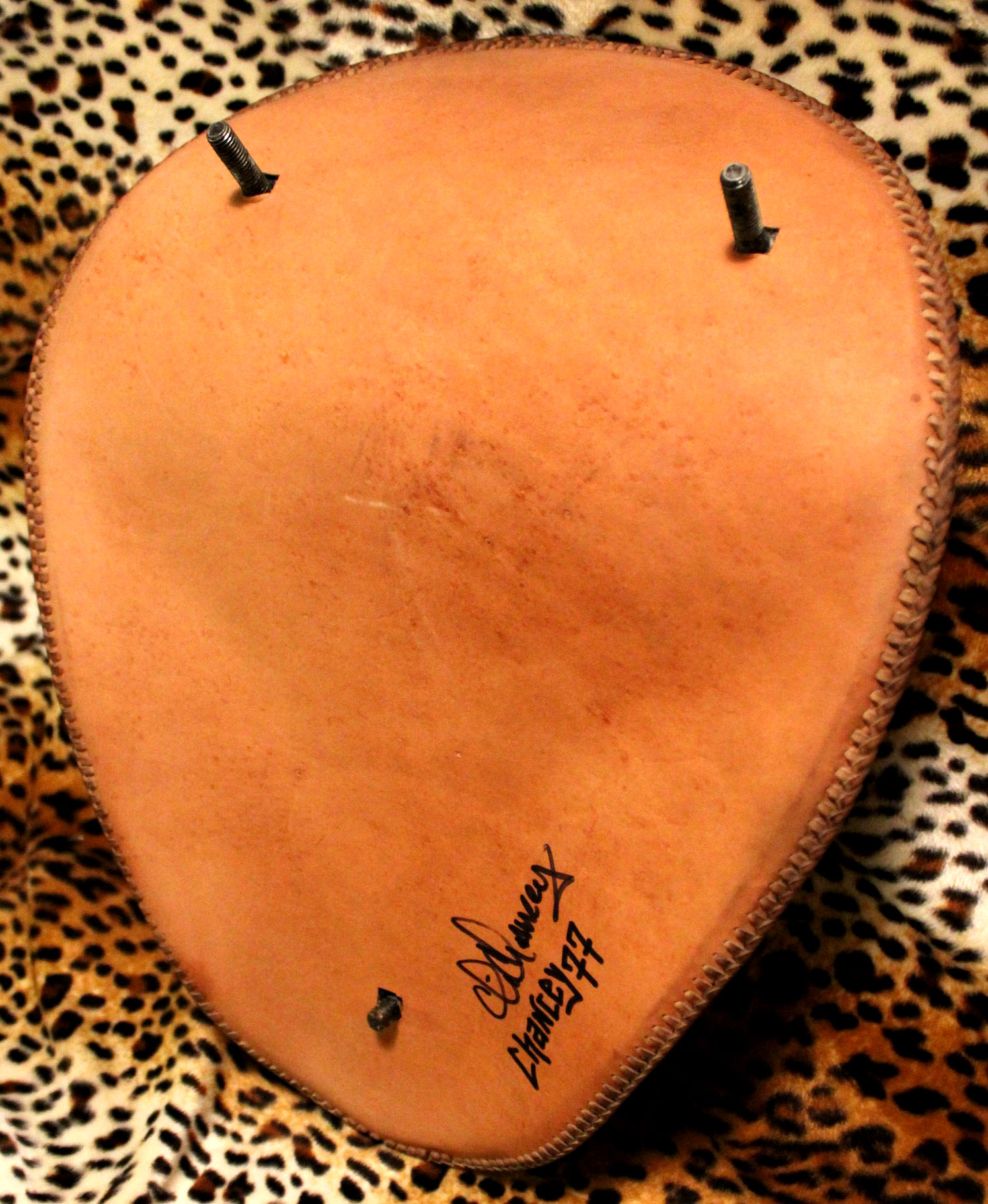

Members chancey77 Posted April 8, 2012 Author Members Report Posted April 8, 2012 ALL DONE! TRIPLE LOOP STITCH 2-3OZ BOTTOM 8-10 OZ TOP NEATS FOOT OIL AND LEATHER BALSAM. READY TO MOUNT. Quote
Phatdaddy Posted April 9, 2012 Report Posted April 9, 2012 I really like it, the camouflage around the perimeter threw me off for a moment, it looked like part of the braid or a row of stitching...Very cool. Kevin Quote
Members chancey77 Posted April 9, 2012 Author Members Report Posted April 9, 2012 (edited) I really like it, the camouflage around the perimeter threw me off for a moment, it looked like part of the braid or a row of stitching...Very cool. Kevin Thanks! So I got the specs on the build today... 1953 Rigid frame and original '53 gas tank with chrome possibly using a leaf spring front end...but maybe not he and a couple different front ends and is still deciding, the old frame is getting a bran spanking new 115 Revtech and 6 speed trans. Candy Apple over Silver with now what is going to be a Matt Finish. With 2 custom made fenders. and of course.... Chaney77 Seat:) Going to be VERY CLASSY!!!!! Edited April 9, 2012 by chancey77 Quote
