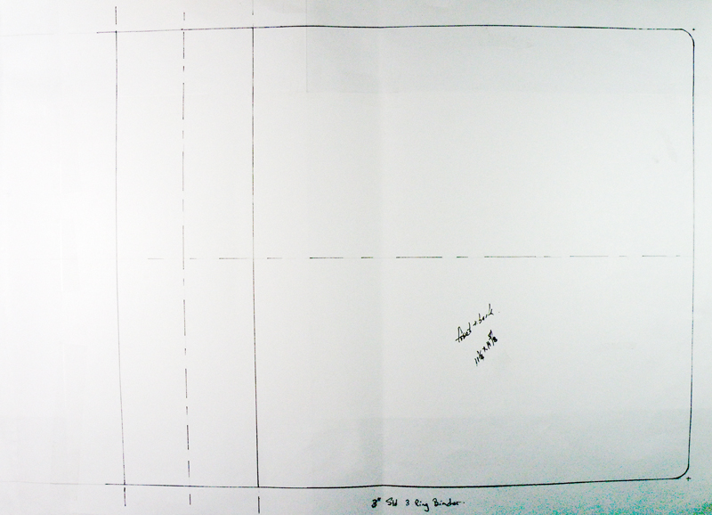

hey yall, looking for any advice on how to build a 3 piece 3 ring binder, any help would be great thanks

I lay out a full size pattern. First photo shows only one side and spine. I layout what I want for a spine to fit the space on the full layout as in photo 2. The front and back pieces go only to the 'hinge'. The spine overlaps onto the front and back covers. The cover and spine are 8 oz. The edges of all pieces are skived before any glueup and sewing in order to reduce the thickness. I also use a stiffener for the front, back and spine. It is cut to leave about 1/2" clearance from the cover stitching and hinge. The lining for the binder is cut to match the front and back. Lining for the spiine is rectangular only, does not extend to the scalloped edges. Cut everything about 1/4" or so oversize.

I didn't skive that thin, just reduced the thickness to about half for the 3 oz and near a third in the 8 oz. I think you would have a hard time making a 'splice' like joint, and keeping everything lined up. Plus for sewing, I think you want to have enough 'land' on both sides of the stitch.
If you skive too thin, there's no room for slips which usually happen to me.
