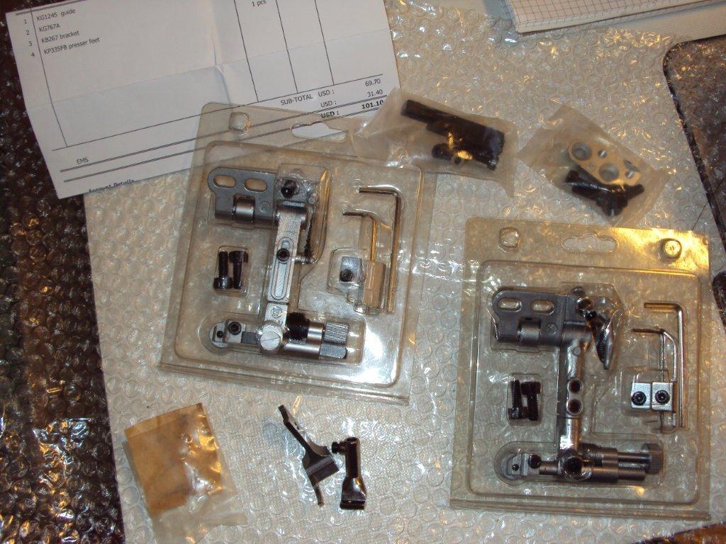

I bought guides for two of my machines; they both made my working day a lot easier.

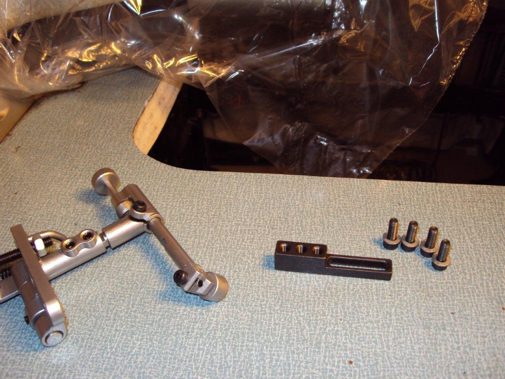

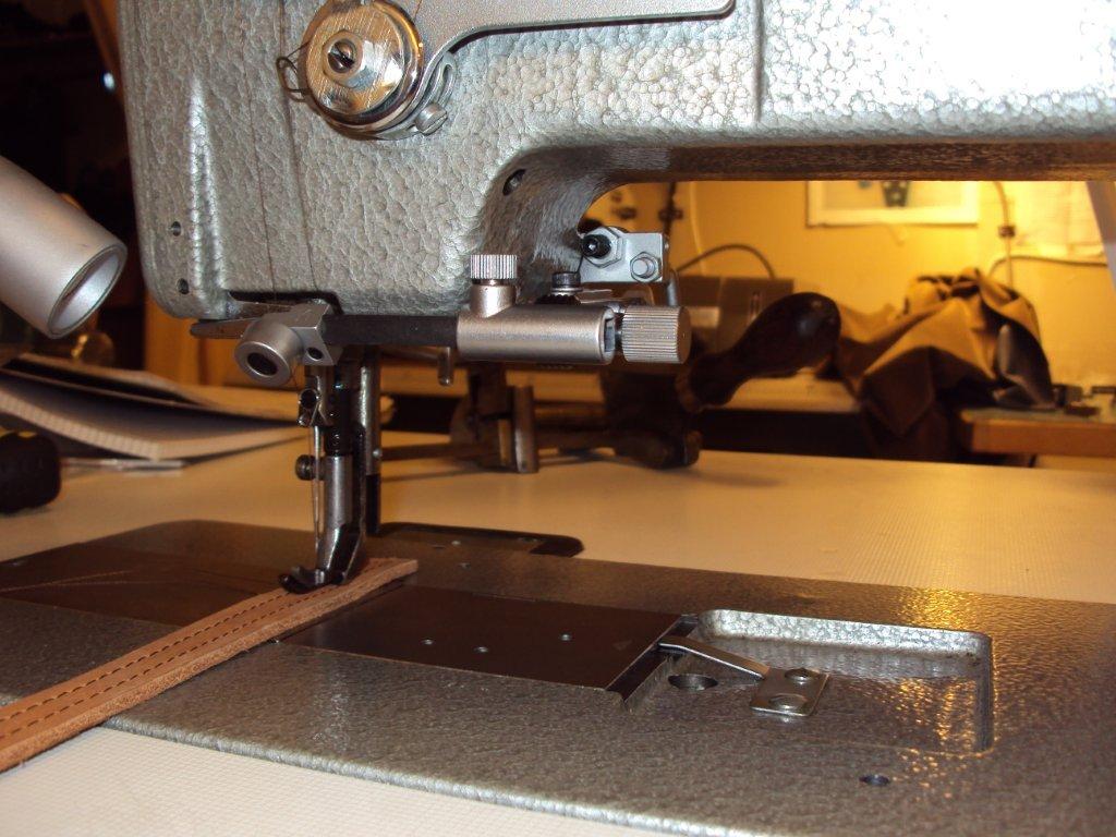

My Dürkopp Adler 267-373 had the two threaded holes (see pic.) necessary to fix the guide. I bought the suspending guide KG767B, $ 22,-, and the bracket KB267 $ 5, 80. The installation was a ten-minute job.

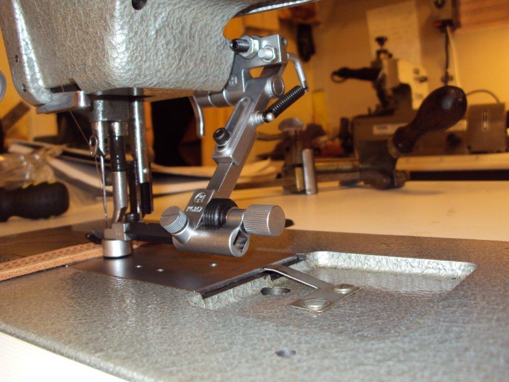

My older Pfaff 345-H3-6C-LN had no such holes, so they had to be made. The guide I bought for the Pfaff is called; KG1245. KG1245 (named after Pfaff most popular sewing machine) is a kit containing the guide KG867 (who also fit Dürkopp Adler 867,767,467 and 267 and more). And a universal bracket to fit many Pfaff classes; the 1245, 335, 345 and more. It will fit many other sewing machine brands too. The kit also contains a roller and a straight guide. . The price was only $ 25, 90. (The same guide is sold for about 125 $ on EBay, the original Pfaff guide will cost you twenty times more)
Both the guides has the same mounting holes and will fit many machines, the brackets are different and made to attach the guides to a particular machine(s).
I preferred the guide KG867 (supplied in the Pfaff kit) better than the KG767B. So I switched them around and used the KG867 on the Adler machine, I use the most.

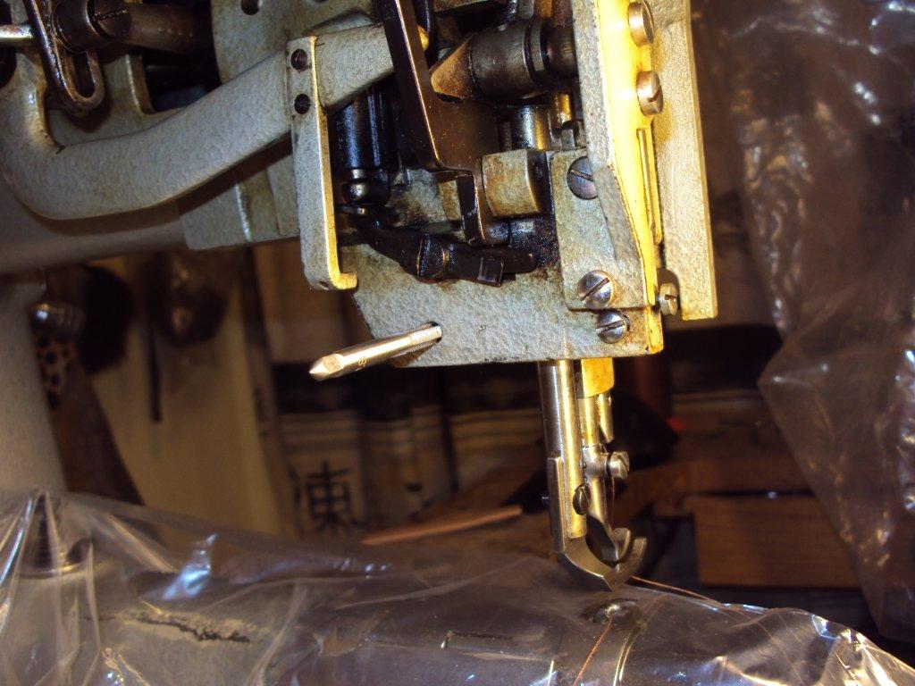

My Pfaff had no free threaded holes on the backside, so they had to be made. The job enquires some mechanical skills. The tools you need for the job is:

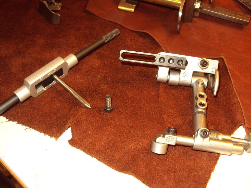

A caliper or micrometer, drill machine, one 3, 5 mm and one 4, 2 mm high quality drill bits. A set of M5x0, 8 threading taps (the set contains three taps) and some cutting oil.
I started to measure out where I needed to fix the guide.
The holes need to be at least 8 mm deep. Make sure there is enough material where you need to drill. Study the machine inside out, read blue prints and part lists. You do not want to drill in the wrong place. If you do, it can be impossible to fix the damages. If you are not sure, let a professional sewing machine mechanic do the job for you.
I will not hold any crash course in threading holes, if you are unfamiliar with this job. Read up on the subject, :google0dw: and find something else to train on. Make your training similar to the job, it easy to thread apiece vertical, it is a more difficult job done horizontal.
Normally a set of threading taps comes in three, the first is a tapered tap to facilitate the initial thread cutting, the second is an intermediate type that is used to progress the thread after it has been started and then finally, a "Bottoming" thread tap. Which is used to obtain the full thread depth, when cutting a thread that does not go the whole of the way trough the piece.
I already had a threading bit set that cover many different threads, but the set was cheap and have only one tap for each thread. Because of this, I had to drill deeper holes to ensure the threads were full depth where my screws were going to be.
I needed to drill 12 mm deep to get full thread length on 7 mm. However, luckily it was enough metal to drill in on the Pfaff head, as it normally is on this kind of sewing machine head.

Some machines may have one screw on the backside used for other things that can be switched for a longer one, and used for the bracket. That way you only need to drill one hole. The bracket will allow many different ways of mounting. The distance between the two screws etc. I believe that many of Kwokhings suspending (dropdown) guide mounts in the same holes. I am sure it is possible to ask for the Pfaff bracket together with and other style of guide.
Look at how the guide spring is fixed; make sure it does not get in conflict with any moving parts on your machine.
Attach your guide; do not screw in those umbraco screws to hard. You will break your threads or guide.
