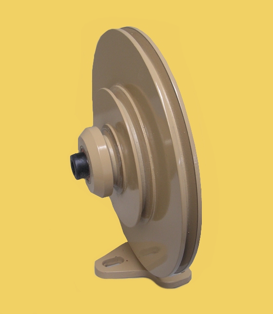

Here is a pic of our (Leather Machine Co., Inc.'s) speed reducer. The belt on the smallest pulley goes to the machine. The belt on the largest pulley goes to the motor.

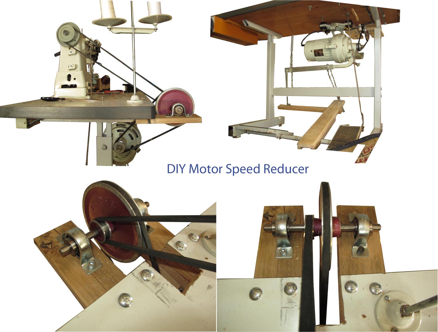

i did actually find a pic of a speed reducer.
$145 plus shipping to Aus and waiting was too hard,
so i made one myself......!!
see the pic.
it might not look so neat and tidy but it works really really well.
now i have the speed i want/ need, nice and slow and very controllable.
before i did the speed reducer i was trying to get more control by extending the clutch arm,
this did help a bit also, so i left that but did not like using my left foot so did another addition so its under my right foot.
so now the whole thing looks pretty weird but HEY!! IT WORKS GOOD!!!
the pressure on the pedal is actually really nice, its like a long throw and sort of soft,
adjusting the tension on the return spring sets it up for the pressure you like.
all together it cost about $110 .
of course the bobbin winder is defunct, so next thing is to do a fix for that.
