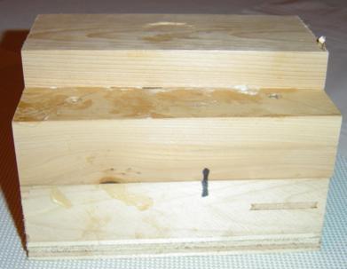

Tree Reaper Posted July 19, 2012 Author Report Posted July 19, 2012 It's important to cover all of the leather and more with light plastic to prevent the foam from sticking to the bottom of the wood mold because it's like glue and will adhere both sides of the mold together. The foam doesn't stick to plastic. Quote

Tree Reaper Posted July 22, 2012 Author Report Posted July 22, 2012 The first mold,I just used a piece of zip lock freezer bag. Any light plastic from even a garbage bag should work. There isn't a lot of stress on the plastic, it is supported by the leather and gets trapped between the foam and the wood top where it can be trimmed off later. Mark your mold block with a sharpie or pen so the screw holes always line up. Quote
Members LederRudi Posted September 7, 2012 Members Report Posted September 7, 2012 I was playing with this idea of using expanding insulating foam to wet form leather projects. This is going to be a guitar pick case, it just requires trimming now and I'm pleased with the results. I'm thrilled by your invention! Would you recommend a maximum leather thickness or a maximum size of a molding project? Quote "If you work for a living, why do you kill yourself working?" Tuco Ramírez
Tree Reaper Posted September 7, 2012 Author Report Posted September 7, 2012 I found the foam only works with small projects using thinner 2-3 oz. leathers. It doesn't have enough pressure for molding thick leather. I tried the large gap foam hoping to get more expansion from it but didn't get any better results. There might be another product out there but insulating foam just isn't strong enough. The advantage is you can fill shallow, odd shapes with the foam, it worked really well on the pick case. I'm back to using wood and now wood or clay to match the mold and getting great results, a huge improvement over tacking leather around a wooden block and trying to form it. Kevin. Quote

Members Horrrk Posted September 10, 2012 Members Report Posted September 10, 2012 Hi Tree Reaper, may I say, what a brilliant way of forming leather..excellent idea.. Thankyou for sharing this.. One thing that I don't think anyone has asked yet.. I take it that you soak the leather and push it partly into the mould before the layer of plastic is added and the whole thing is clamped shut? I can't imagine the leather, nor indeed the plastic, wanting to stretch that much from flat without tearing, is all.. Regards Phil Quote Being defeated isn't the worst thing in life..giving up, is..
Tree Reaper Posted September 10, 2012 Author Report Posted September 10, 2012 Hi Phil; Yes the leather is soaked under water until saturated then placed over the mold and worked into the cavity with a rounded end of a wooden dowel to get the shape started. I wrote the company that makes Great Stuff and asked them what the lbs./cu. ft. is of their product so maybe we can get a comparison of other products on the market. I would guess that you would require at least two to three times the force of Great Stuff in order to mold 5 oz. leather into a 1 inch deep pouch. Quote
Tree Reaper Posted September 10, 2012 Author Report Posted September 10, 2012 They didn't answer my question but this seems to be the general response. we only measure it in lineal feet. 12oz can at 3/8 inch bead of Gaps & Cracks - measures theoretically 259 lineal ft. Quote
Members Horrrk Posted September 10, 2012 Members Report Posted September 10, 2012 (edited) Hi Phil; Yes the leather is soaked under water until saturated then placed over the mold and worked into the cavity with a rounded end of a wooden dowel to get the shape started. I wrote the company that makes Great Stuff and asked them what the lbs./cu. ft. is of their product so maybe we can get a comparison of other products on the market. I would guess that you would require at least two to three times the force of Great Stuff in order to mold 5 oz. leather into a 1 inch deep pouch. Thanks for your reply Tree Reaper, I figured it was something along those lines.. As far as the response from the company, it does sound like a general reply..nothing to do with a question of force or pressure.. I guess they've not had your question posed before..only for the amount of foam, people can expect out of the can.. Maybe with the tougher leathers, we're moving into the realms of hydraulics?? A little more fiddly perhaps, but not rocket science..lol Regards Phil Edited September 10, 2012 by Horrrk Quote Being defeated isn't the worst thing in life..giving up, is..
