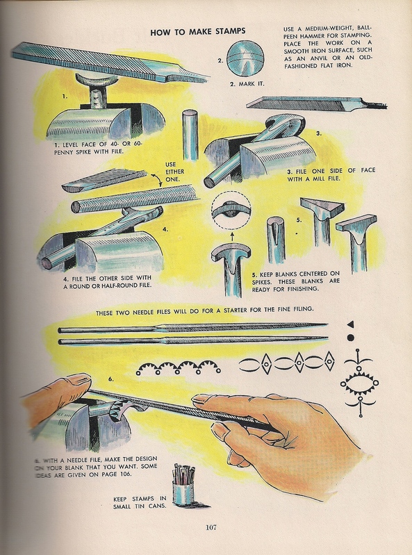

Members camano ridge Posted August 1, 2012 Members Report Posted August 1, 2012 (edited) On 8/1/2012 at 4:43 PM, CountryStyle said: Hello everyone, Well as usual I am trying to find ways to improve my work without spending money (because I have none). Was trying to figure out a way to make a nice straight border on my belt without buying a tool, so I found a cheapo wrench out in my garage and was able to make a straight border line with it. I plan on cutting it with my swivel knife and then beveling it. We shall see how it turns out, but I think it will be ok. Any other ideas on how to do borders with household things? Here is a thread that discusses making stamps: http://leatherworker.net/forum/index.php?showtopic=10252&st=60. I have also attached some pages showing diffrent stamps made from bolts using files no grinder. Edited August 1, 2012 by camano ridge Quote https://www.facebook.com/CamanoRidgeCustomLeather?fref=ts

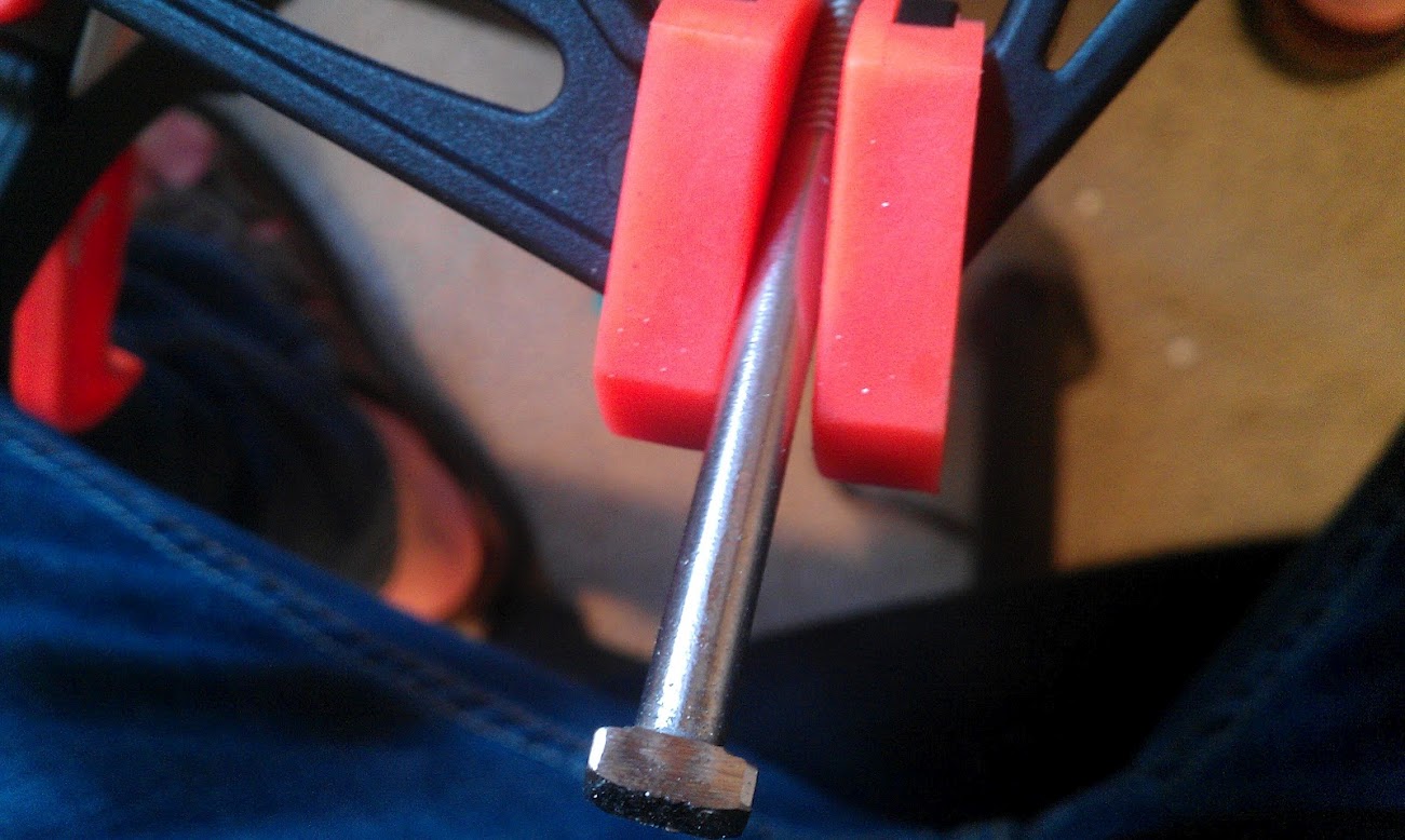

Members CountryStyle Posted August 2, 2012 Author Members Report Posted August 2, 2012 UPDATE: Ok so after filing/sharpening the wrench, it cuts like a dream. Just as good as a swivel knife! This is perfect for borders. UPDATE: Ok so after filing/sharpening the wrench, it cuts like a dream. Just as good as a swivel knife! This is perfect for borders. Also, I made one of those fancy pants double bevelers from a stainless steel bolt. It works well, but could use some improvement. I have attached some pictures for you all to see. Homemade border tool, homemade beveler. Quote God is Great! Nathan Allison

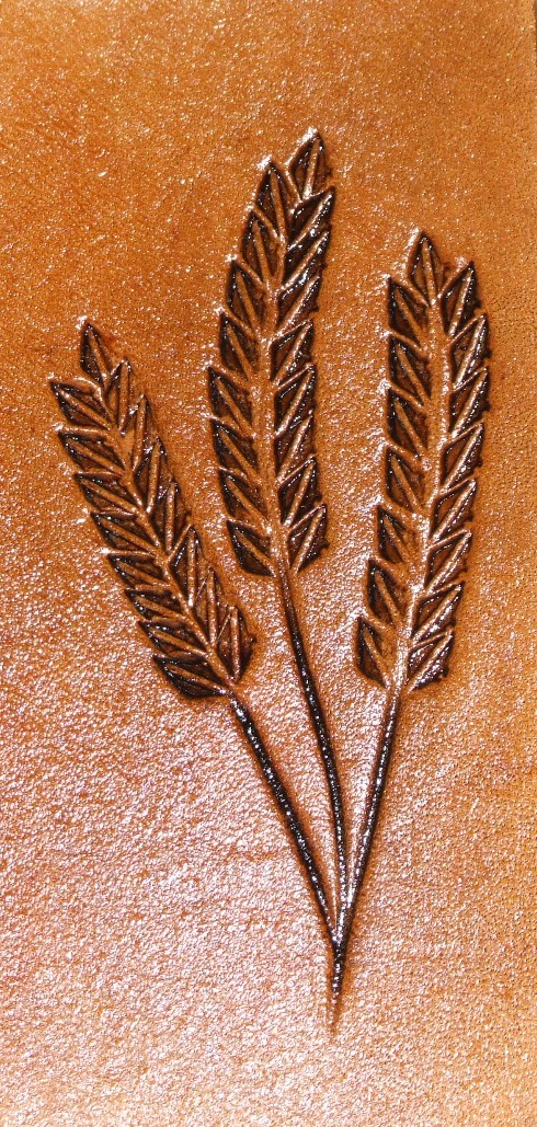

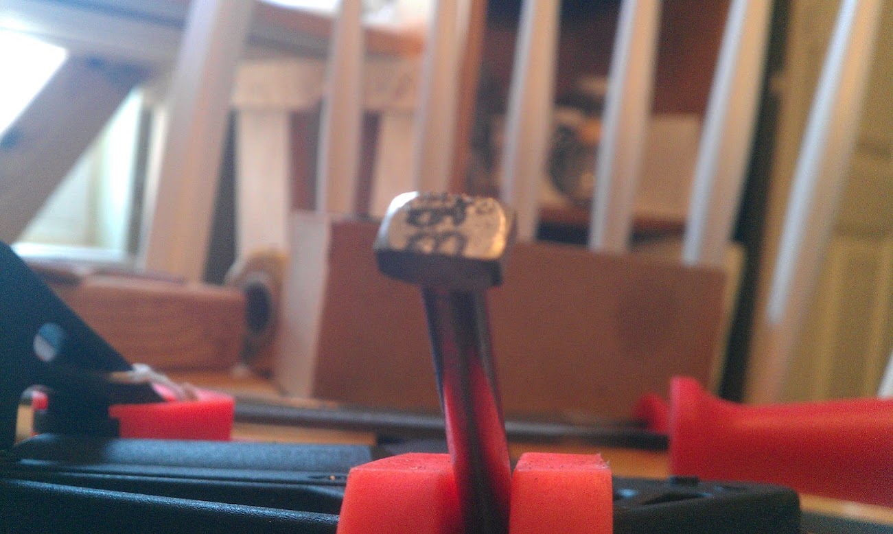

Members celticleather Posted August 2, 2012 Members Report Posted August 2, 2012 Here's a couple of tools I made about 35 years ago. They're made from 3" nails, by filing down the heads. The second picture is an example of the wheat ear that can be created. I still use these two tools regularly! Quote When everyone is somebody, then no one's anybody
Members CountryStyle Posted August 3, 2012 Author Members Report Posted August 3, 2012 Celticleather, Thank you so much for posting those pictures!!! that is great information and I will probably make some of these on my next day off. I love it when people post stuff like this to help others out! Quote God is Great! Nathan Allison
