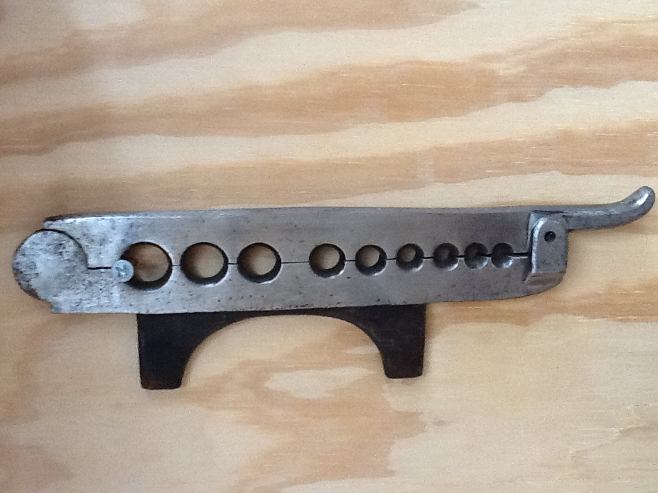

Members Rawhide Posted August 4, 2012 Author Members Report Posted August 4, 2012 (edited) Here's a picture Edited August 4, 2012 by Rawhide Quote Marlon

Members amuckart Posted August 4, 2012 Members Report Posted August 4, 2012 Judjung by the picture, that's not in bad shape, all I'd do to it is polish the channels if they need it and be done with it. If its dirty, just wash it in some very hot very soapy water, dry quickly, spray with WD-40 to displace the moisture in the hinge, wipe downand oil lightly. Quote -- Al. Medieval Stuff: http://wherearetheelves.net Non-Medieval, including my machines: http://alasdair.muckart.net

Members Kevin Posted August 5, 2012 Members Report Posted August 5, 2012 I would just use triple 0 steel wool to get any rust that might stain your leather, it doesn't really need to be polished, in my experience, a little texture helps to burnish. I wouldn't oil it unless you aren't going to use it for a while or it's in a very humid area. Good to see you, Kevin PS Using it will polish it. Quote
