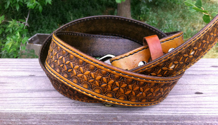

I got a big spool of it and have been using it for hand stitching. Been workin very well.
Here's a pic of it dyed black
