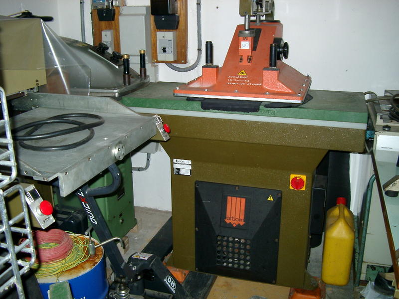

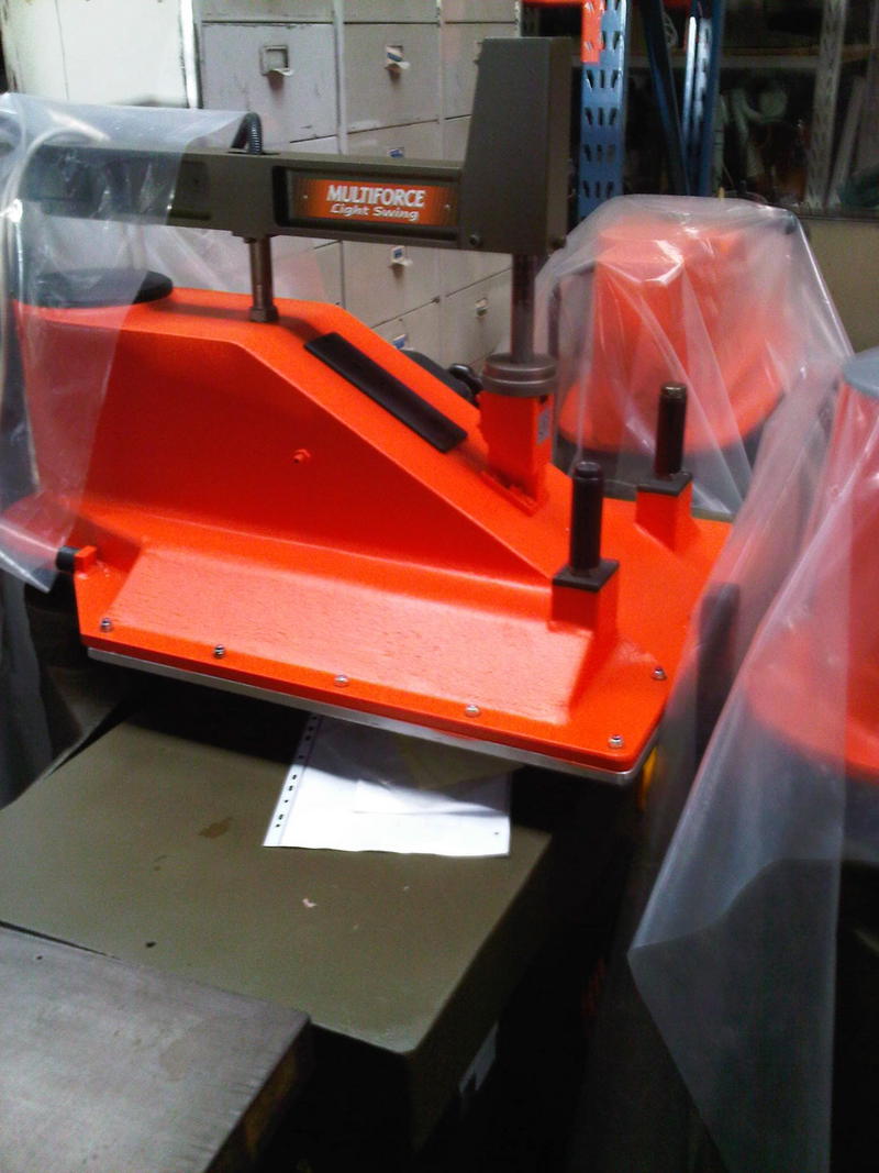

I've got the option between an older model Atom G222 and a newer one Atom MF( Multiforce).
First two attached photos are of the Multiforce and the last one of the G222.
We are making leather bags, please see grafea(dot)com
The major differences between the two are obviously the price:
Atom G222 ( £2350 or $3800 ) refurbished from the official distributor
Atom MF( £4000 or $6450 )
Cutting Pressure G222 is 16Ton where MF is 25Ton
and also the MF has an automatic adjustement for the height of the dies as well as assisting with the swivel to
reduce the operator's fatigue. On the G222 you will need to adjust the cutting depth manually.
We will probably use the same height of dies for all of our bags.
Is there a reason if both machines are in good working order to pay an extra £1650 or $2655 for the MF machine?

I have one similar to the 222. When I order clicker dies, I specify 1 1/4 inch. I use the handwheel on top occasionally to make minor adjustments. Usually just turn it on and use it. As far as power assist on the swing arm, we all need more exercise, not less. I assume there is a need for more automation, but for leatherwork, I just don't need it.
Art
For heaven's sakes pilgrim, make yourself a strop!
How many hours a day will you have the same person using the press? I can click for four hours straight on an old Atom 25 ton, then I'm wiped out and have to take a nap. If you're going to have the same person clicking eight hours a day get the assist.
