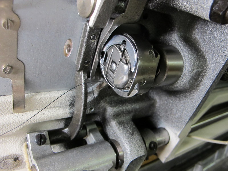

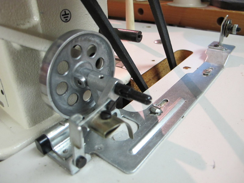

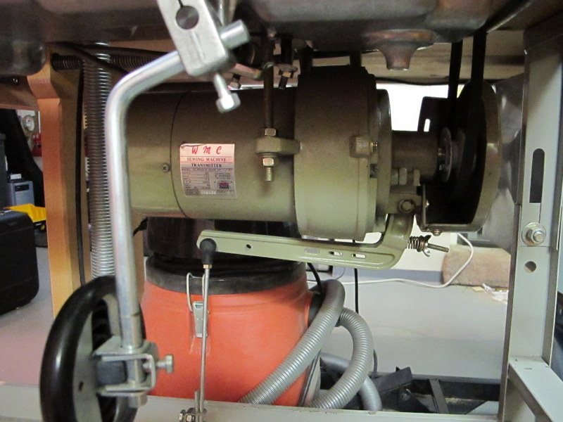

I'm new the the forum and I'm here with the hope to learn about sewing in general. I work in the marine industry and recently bought a used Juki DDL 8500 in great condition to learn on. My primary application is boat upholstery and canvas work with some leather here and there. The machine has a 3500 rpm clutch motor that I've adjusted and works fine. Here is my problem: Machine runs way too fast even with a new 2" pulley. Even when I slow it down by feathering the clutch, I find my vinyl slips around corners or over bumps/piping. When feeding, I can't get consistent stitch length because the motor is far too fast between speed transitions or when re-positioning materials (vinyl for example). Tried with regular fabrics and no problem there as long as you want to go fast. One idea is to replace the motor with a Reliable Quietsew 5000 high end servo motor with a smaller pulley but I still think vinyl fabrics will slip too easily.
I realize I probably should get a walking foot asap. I tried a Sailrite LS-1, Juki 1541 and a Sunstar KM-340BL and a Consew 206RB, all walking foot machines. The sailrite would probably work just fine for me (easy to control) but I found it ran like a tractor. I'm a bit of a gear head and would like to get a nicer industrial machine (and I got the bug). The Juki 1541 was a dream and even though I can afford it, I would like to try to stay within a $1000 budget roughly. The Sunstar is a Korean machine and seemed fine although I can't remember if it was a regular walking foot or compound. Sales rep tells me to stay away from the Consew as it's made in china now.

First off, replacing your clutch motor with a servo motor will definitely help you decrease the stitching speed on your Juki 8500, however this is not a walking foot machine and you need one when you're doing boat upholstery and leather work. Otherwise, sewing multiple layers will result in slipping and uneven stitching.
All of the machines you mentioned on your list are compound feed aka walking foot machines. I would advise against going with something portable as you won't have the motor power, speed control or presser foot options that you will with a full-sized industrial sewing machine.
