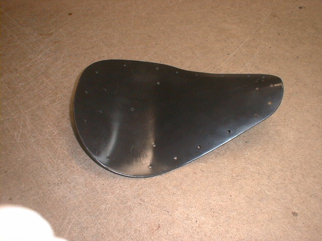

I do gun leather and western saddles, I've done one set of motorcycle bags that almost gave me a nervous breakdown (lol) and have been asked to cover a metal seat for a restored HD 883 hardtail.
One of my customers brought me the metal seat, I told him I probably would not be able to spend the time right now researching and experimenting with covering it. It's for a friend of his and he insisted I keep it and give it some thought.
The owner wants a nice heavy, 6 oz. or so black skirting leather cover with no more that 1/2" pad and no piping or designs. Old school is what he said.
I have no idea where to start.
I can take a pic of the metal seat foundation if needed.
I have looked at some tutorials here and everything seems to use piping.
If any one has any suggestions it would be helpful and in the off chance I will not do it, is there any one here that he can ship the seat to and discuss what he wants and then get it?
I think this customer just has too much faith in my abilities and I would at least like to send him to some one who can do it justice.

Not sure where the seat came from, he just handed me a metal seat base with the bolt studs on the bottom.
The piping I'm referring to (probably the wrong term) is the round leather covered cord that is sewn around the edge of the seat to help the bend over at the edge of the seat. On a saddle I would call it a welt.

Top and underneath views, so we can see the shape and also how the cover fastens already, if it has one?

Here are a couple of pics of the seat they want me to cover. Hope this helps.
Simplest and easiest, would be to follow Roger's tutorial on how he stretches leather over the edges and rivets it to the underside, smoothing and cutting off extra as he goes. That will eliminate the lace or "piping"
Yep, that's what I was hoping to see out of the pan. You can either stretch it over, or follow one of David's tutorials but just saddle stitch the two pieces together instead of lacing it. I would also use some closed cell foam (easily available as "gym foam"). That will match the customer's requirements and be pretty easy to get done.

1st is the mounting bolts on the Pan? I see the bolts for the swing arm but not the springs!
So get those wielded in first and clean up those sloppy wields.
after that;;
Foam: get some black closed cell foam or even the kind of foam used in gym matts, but it needs to be a closed cell no matter what. Home Depot should have some 1/2"-1" closed cell for wrapping pipes with normally sold in 4x8 sheets.
1. Spray glue or Contact Glue on the foam and leave it bigger than the pan at first after it is glued on take an old sharp knife and cut off the extra foam.
Get yourself a sanding drum paddle thing that goes on a drill and round off the edges and shape the foam.
like in this link....
http://leatherworker.net/forum/index.php?showtopic=39248
2.Make your leather pattern 1cm larger than the pan after the foam is on.
Do this for the bottom as well, but I tend to leave the bottom ruff cut much bigger until it is dyed/stained/oiled and ready to glue on.
3. Do your tooling or whatever you want on the top piece, then contact cement the top on and the bottom and then use a pair of shears or heavy scissors to cut the bottom to the shape of the top pattern....
Punch holes for lace or sew it together however he wants it.....
