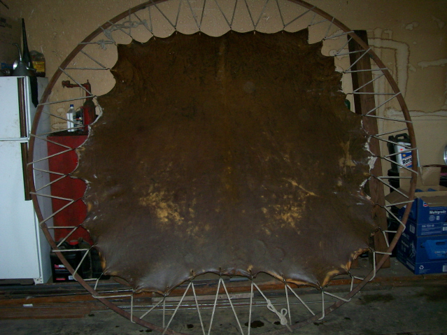

Members rgerbitz Posted August 22, 2008 Author Members Report Posted August 22, 2008 Thanks for breaking down that paper a little for us Denise. It all makes alot of sense. I just strethed out my last hide in a frame last night to let it dry. And while I was able to remove the majority of the hair there were just a few more stubbourn than the rest. I whole heartedly agree with the temp. thing. The previous hide I did I know sat in water that was to hot for to long, and that made it so that when I went to scrape or scud the hair off I could easily break through the top layers of hide. This last hide in an attempt to keep the odor down abit I added a healthy dose of antibacterial dish soap and an ounce of clorox to the lime bath to help control the bacteria, and I believe it worked at least I haven't heard my wife and daughter gaging when they walk through the barn this time. And I think ( not Know, THINK) that the soap helped in getting the surface of the hide cleaned up alittle better. I am hoping that with in the next two weeks I will be able to try the sodium sulphide on a hide. Quote http://gerbitzquarterhorses.com/
