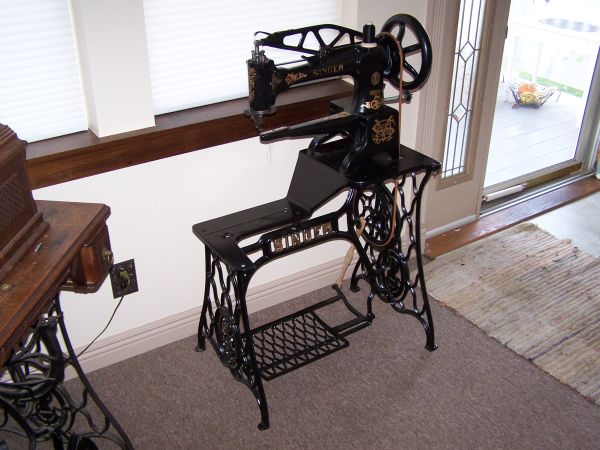

Members sinpac Posted January 7, 2013 Members Report Posted January 7, 2013 On 1/7/2013 at 3:12 AM, Nightshade said: From the pix in the manual it looks like the bobbin clockwise when you put it in the case(with the wide opening up). The manual is very sparse with exact details... Quote
Members Nightshade Posted January 7, 2013 Author Members Report Posted January 7, 2013 (edited) Much prettier than mine... Is there a service manual available that tells how to clean and adjust...well everything? Edited January 7, 2013 by Nightshade Quote
