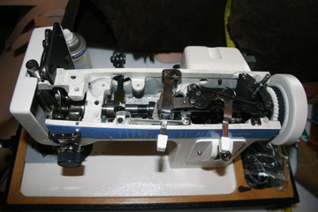

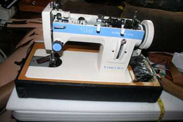

esantoro Posted January 19, 2008 Report Posted January 19, 2008 I finally got my portable zig zag walking foot machine, which I'll be using for denim, suede and lighter leather and 138 thread and lighter (curious to see what this machine will do with 207 thread). I went with the less expensive yamata $300 shipped rather than the Sailrite. With the money I saved, I bought sailrite's awesome case for about $100. Now that I have this machine I'm very curious to know what the Sailrite looks like inside. I'll post pics soon of my yamata. If anyone has a sailrite ultrafeed, could you post some pics of the inner and under workings? I was wondering if there is something people put down underneath the machine and inside the portable case to absorb machine oil. For right now, I have put down kraft paper. ed Quote http://www.waldenbags.com http://www.waldenbags.etsy.com
