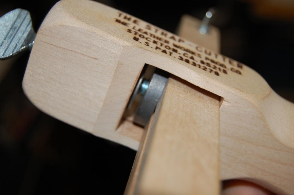

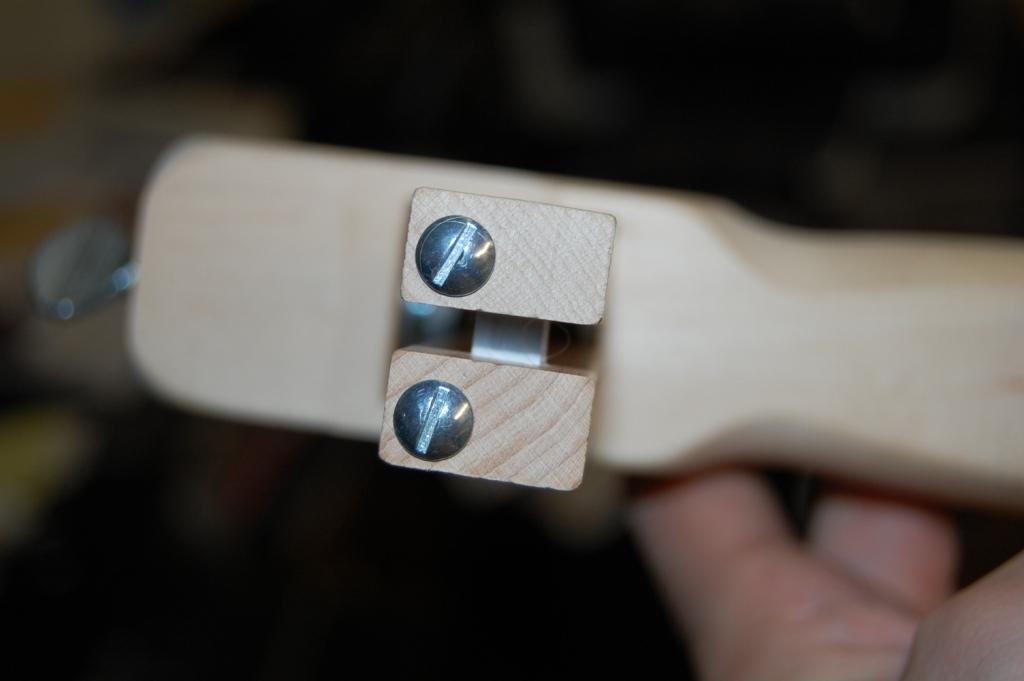

Members spooky Posted February 13, 2013 Members Report Posted February 13, 2013 Okay, doofus newbie question. I boight a wooden strap cutter before Christmas, but life got busy and it got put aside. I know that it came with instuctions on how to put a blade in (didn't come with a blade in), but i've managed to "file" the instructions in a very safe place.. ie I cannot find them! I have managet to pull the strap cutter apart (perhaps I shouldn't have!!!!), so know I have two separate wooden pieces, and a round metal disc thingy, that fell out, that should go "somewhere"! I'm sure it is the sort of thing that once you have done it once, it's easy, but I cannot figure it out. So, once you have all finished laughing and splerking into your coffee, this newbie would be very grateful for some simple, clear instructions. Quote
Members Cyberthrasher Posted February 13, 2013 Members Report Posted February 13, 2013 pictures on the way Quote hellhoundkustoms.wordpress.com www.facebook.com/hellhoundkustoms www.etsy.com/shop/HellhoundKustoms
Members Cyberthrasher Posted February 13, 2013 Members Report Posted February 13, 2013 Step one: The round metal thingy goes here (sounds like a good term to me) and is used to keep the crossbar solid with pressure from the main thumbscrew. Make sure your blade is on the side of the handle that has this round cutout on the side. Step two: The blade goes here in the slot that's at the 0 mark on the ruler. It should go BEHIND the screws. These screws hold the blade in place and at the same time that keeps this end of the crossbar set at the proper thickness. You'll need to loosen that top blade screw in order to adjust the thickness. It can be really hard to get into the slot, so take your time and don't cut yourself. another view to show where the blade sits. This is the thickness adjustment for the otherside of the cross bar. You need to make sure that the thickness is equal across the entire length in order to get a nice clean cut. You will need to loosen 1 blade screw, this little thumbscrew, and the main thumbscrew in order to adjust the thickness. Springfield leather has a good video on their youtube page that shows all kinds of stuff about this great tool http://www.youtube.com/user/SpringfieldLeatherCo Quote hellhoundkustoms.wordpress.com www.facebook.com/hellhoundkustoms www.etsy.com/shop/HellhoundKustoms
Members spooky Posted February 13, 2013 Author Members Report Posted February 13, 2013 Thank you! I've manages to get the two wooden pieces back ogether... yay! So much easier when you have the orientation right and they fit! I assume that the divot thing on the metal thingy sits facing the screw? Also, does the blade go across both the skinny wooden bits? Off to find a screw driver. Quote
Members spooky Posted February 13, 2013 Author Members Report Posted February 13, 2013 Yipee-yii-ya!!!!! I think I got it! One of the slots was so narrow you could barely see it, so struggled to get the blade in, but now in. Once you have the instructions, not that hard. Off to try cutting some scraps then watch that video. Thank you sooooooo much for helping out a newbie. You may now return to splerking your coffee Quote
Members Cyberthrasher Posted February 13, 2013 Members Report Posted February 13, 2013 Thank you! I've manages to get the two wooden pieces back ogether... yay! So much easier when you have the orientation right and they fit! I assume that the divot thing on the metal thingy sits facing the screw? Also, does the blade go across both the skinny wooden bits? Off to find a screw driver. Yes, the blade should go through both pieces with none of it sticking out. I haven't had the plate out in a while, but I'm pretty sure there's a little dimple on the side that is pressed in with the screw, and the other side has a larger flat surface that contacts the crossbar. Just in case, all those pictures will expand to full screen if you open them up. Yipee-yii-ya!!!!! I think I got it! One of the slots was so narrow you could barely see it, so struggled to get the blade in, but now in. Once you have the instructions, not that hard. Off to try cutting some scraps then watch that video. Thank you sooooooo much for helping out a newbie. You may now return to splerking your coffee Nah, it's too late for coffee. Almost bedtime, so you are splerking free Quote hellhoundkustoms.wordpress.com www.facebook.com/hellhoundkustoms www.etsy.com/shop/HellhoundKustoms

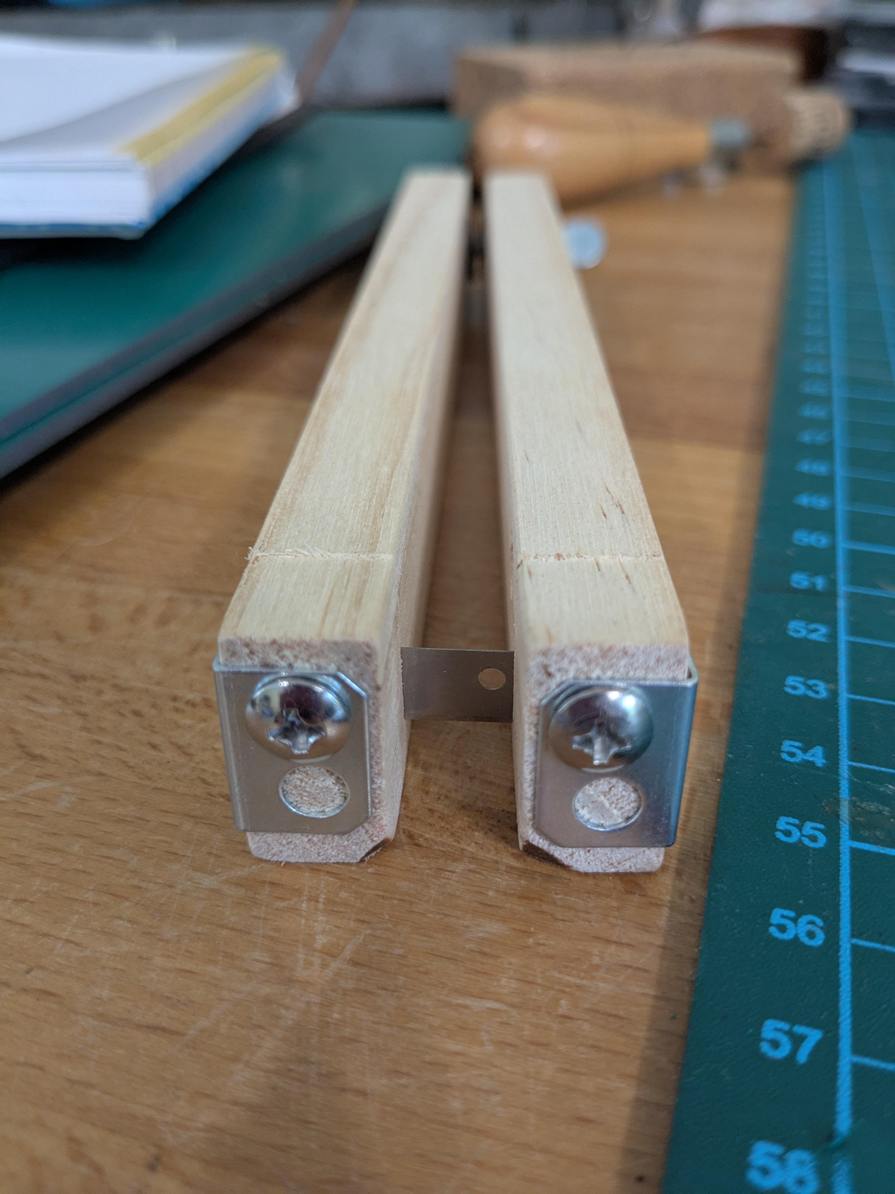

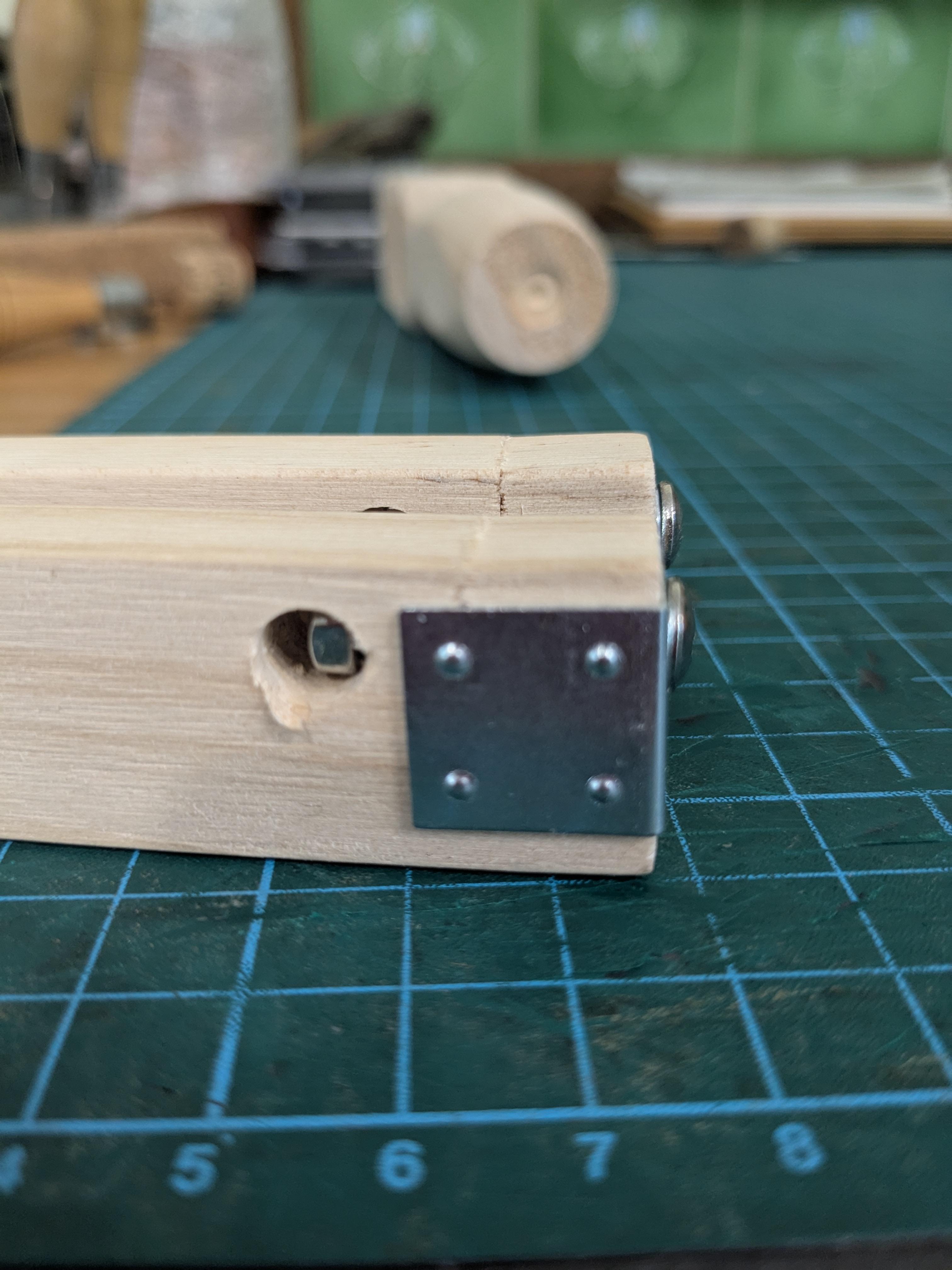

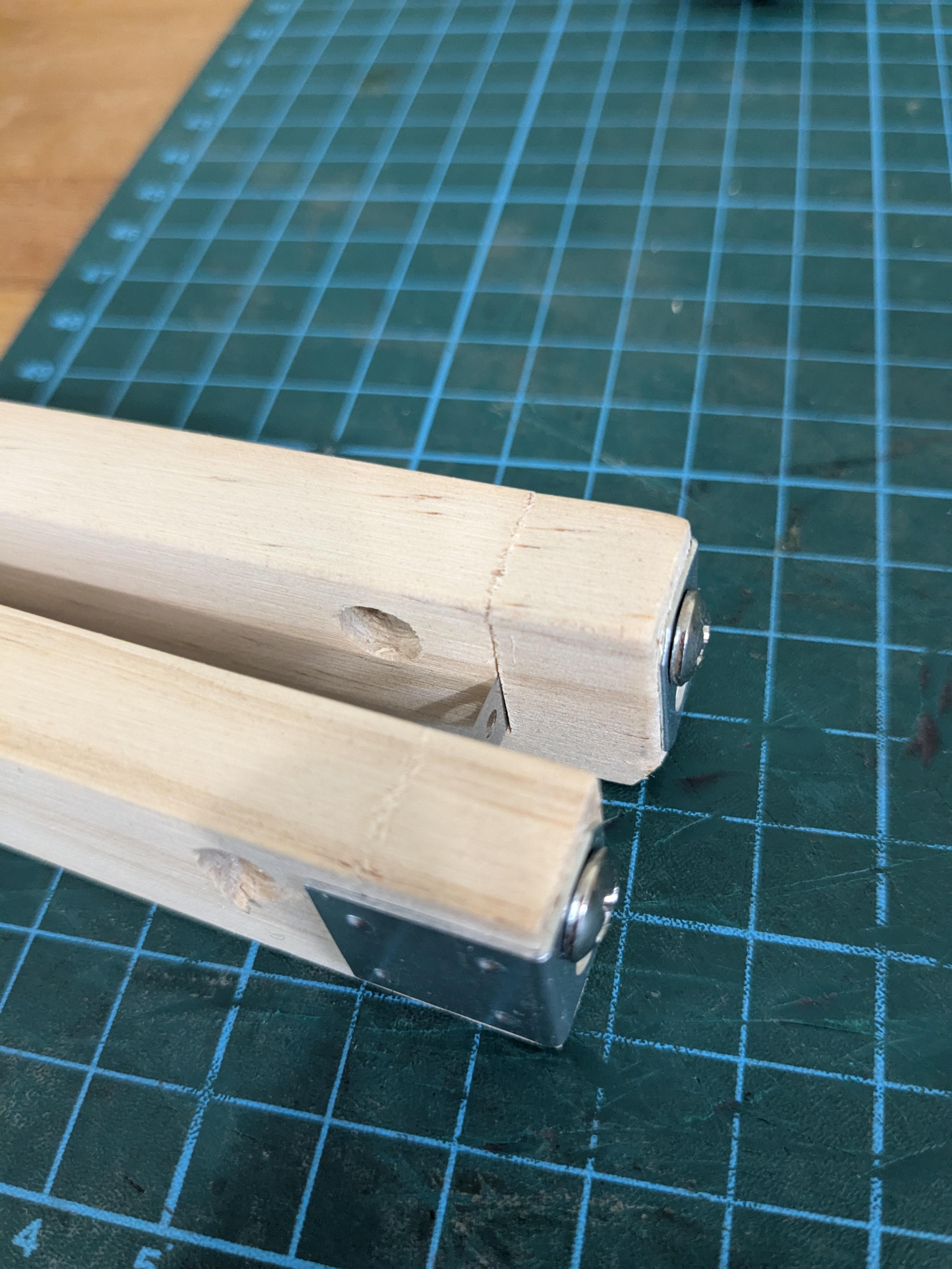

Members miasabel Posted Friday at 06:48 PM Members Report Posted Friday at 06:48 PM (edited) One of my students has bought a Destnule strap cutter and I cannot position the blade in the arms so that the screws tighten it. The screws tighten but the blade is still loose. Any ideas? Edited Friday at 06:49 PM by miasabel duplicate photo Quote
Contributing Member fredk Posted Friday at 07:21 PM Contributing Member Report Posted Friday at 07:21 PM Run a file or fine saw on the outside parts of the blade slot to widen it and give more 'squeeze' room there. Make sure the captive nuts aren't turning as you tighten the bolts Quote Al speling misteaks aer all mi own werk..
