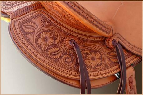

Goldshot Ron Report post Posted February 21, 2013 (edited) Gordon uses the Sheridan style of tooling, but his acanthus leaves are larger and fill in more area. His approach to flow of the pattern starts at the top of the vinework and flows down to the start of the vine; instead of starting at the ground and moving upward. I found that this technique helped me with my leaves being more flowing than starting at the ground level or bottom of the design and working upward. The two photos show some of his work. Edited February 21, 2013 by Goldshot Ron Quote Share this post Link to post Share on other sites

Bob Blea Report post Posted February 22, 2013 Thanks Ron, I get what you mean, and his work is really really good. I visited his website and there is some really nice work on there. Bob Quote Share this post Link to post Share on other sites
