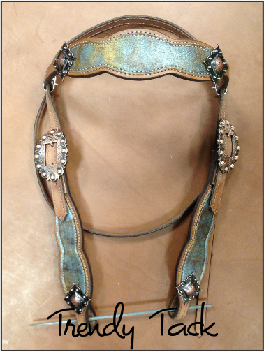

cmantz Report post Posted March 25, 2013 So, I am making my first headstall...and then breast collar. Pieces are cut out for the headstall. I am using a 8 oz. bridle leather that does not require any stain or dye. I am planning on doubling the cheek pieces, the browband and possible the crown strap. The cheeks and browband will have a lightweight (2-3 oz) overlay on them with spots along the edge. So, what is the best order of attack? I am assuming I do in this order: glue bevel edges (not sure when to do this...before they are glued, after they are glued, before the edges are sanded, after sanding???) sand edges burnish edges condition stain edges sew apply overlay sew add spots add hardware Is this correct? I don't have to dye the leather for the above set but I am assuming if I do, I would dye the pieces after they are cut out and before they are glued, correct? Quote Share this post Link to post Share on other sites
JJs Leatherworks Report post Posted March 26, 2013 Christine, Project sounds ambitioius. Doubled up 8 oz plus an overlay is going to give you pretty thick material for your cheek and browband. Where you have to double up the straps for buckles or other hardware to be attached with chicago screws or rivets, you will have lots of skiving to do to make it manageable. I seldom make headstalls with a total thickness of more than 12 oz, many are just single thickness 8 - 10 oz. Once your pieces are glued together, you will want to sand before doing the beveling of the edges (if your edges aren't even before you sand and you bevel first, as you sand, you lose some of the bevel). Many items, I do not sand until after they have been sewn, as sewing close to the edge with a machine will often cause small buldges in the edge by the needle holes and sanding afterwards, gives a nice smooth edge. Depending on the pattern and layout of your spots and proximity to your sew/stitch line, with the thickness of your finished straps, you may want to consider putting the spots on the top layer before assembly (will allow the prongs to clinch the material better). Not sure what is holding your overlay in place without seeing a pattern - will it be stitched as well? do the spots hold it in place? Just a few considerations for your headstall project. I hope I haven't added to your confusion. Some steps are cut and dried, but others, depending on the project can be altered. There is no one 100%correct order to do it. Looking forward to pictures when complete. JJ Quote Share this post Link to post Share on other sites
cmantz Report post Posted March 26, 2013 JJ Wow...36 views and one response Thank you for that!!! I truly appreciate your offer to share some tips to me. It sometimes seems as if I am asking for the recipe for Bush's Baked Beans LOL!!! I know some of the more seasoned tack makers probably read it and thought "not this question AGAIN" but I did attempt to search the forum before I posted. Man...how I wish I could find a mentor. How nice would that be if you could just shot someone an email with the silly questions asked by most newbies? Edges....yeah, I can see now that I need to edge after I sand I edged the top pieces (cheeks and browband) and then glued them. Then I sanded them. I hadn't edged the back so did that after I sanded and that worked out much better. So today I learned...sand and then edge! As far as leather weights. A friend had a tack set that she bought from Heritage Leather when she was at the NFR and I used that as my "inspiration". From what I can tell they used two layers of 8oz leather and then had some hair-on overlay. The leather I am using seems to be fairly soft so hopefully it won't be too thick. The overlay will be glued and then sewn and then spots added to the edge so I will have to add the spots at the end. I have a Standard Rivet spot setter so hopefully they will stay in place pretty good. I will be happy to post pics when I am done. I need all the critiques I can get so I can learn and improve. Believe me, I am my biggest critic...but I suppose I am no different that most. Quote Share this post Link to post Share on other sites
cmantz Report post Posted March 27, 2013 So, headstall is almost finished...just need to add the spots. Quote Share this post Link to post Share on other sites

cmantz Report post Posted March 28, 2013 JJ...that is actually not hair-on. It is "Dakota Side" from SLC. I bought a small piece (about 3 sq ft) a couple months ago and I loved the color. Looks great with the bridle leather I bought. So, I bought some more and it was totally different. Had a much more pronounced "crackle" effect on the surface and the colors were completely different (the second piece had a lot more turquoise in it). I like the color of the second piece but wasn't sure about that crackle surface holding up well especially for tack. In all my years of sewing, I understand dye lots but this wasn't even close. The only thing they could figure out is that the first piece I bought came from a corner. I just would have expected it to be a closer match since it is a man-made effect. Thankfully I have enough to make the breast collar and probably tie down from the piece I have. Here is a picture on her horse. Makes her look so pretty Quote Share this post Link to post Share on other sites
