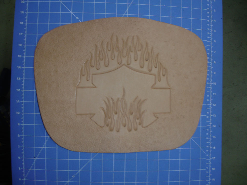

I have the Seat panels all carved and ready for stitching. Here are a few pics:
Whatcha think?

Looking good Troy, well done so far!
You got it all figured out and sketched/calculated down or do you just take it as it comes.
Looks like you got a plan worked out allready. I'd scratch my head for month's before getting started on such a project, lol.
I't gonna be very interesting to see more of this, I'm thrilled!
Tom
That looks great Troy!! I like the flames and stripe, what colors are you going to be using? Can''t wait to see pics with it on the bike!
Very nice so far. Looks like one hell of a project. Good luck and be sure to keep posting pictures. Looks like its gonna be a very cool ride when your all done.
What colors are you planning or gonna do a natural look.
That looks really good. Did you use the original seat cover as a pattern for the leather? I'm supposed to do a stock Softail seat and I'm kinda nervous about cutting a bunch of leather and then finding out it's wrong. Have you taken any in-process pictures, or could you take some as the assembly process begins? Can't wait to see that all done.

Thanks man! Yeah, I planned it all out. I've been working with the owner of this scooter for weeks getting it all together. He's been looking for someone to fix his old leather for months. I did a seat for another guy about 6 weeks ago, he saw it, and the rest is history! I carved both saddlebag lids and the passenger backrest yesterday. I'll be starting to stitch it all together today! And, Tom, I've seen your work bud, and you don't look like you'd do too much head scratchin'! You do nice work!
Brad,
I'm going to highlight it with Timber Brown. No other color... I'm using RED thread to sew with and RED and TAN Suede lace for some very minor details....
Grumpy,
Yes, I did use the original seat cover as a pattern. The original cover was made of marine vinyl and had stretched out. I disected the original cover at the seams, then I used BLUE PAINTERS TAPE to tape the old pieces to posterboard, then added 1/2" for unforseen boo-boos!
Thank you ALL for your words of encouragement! I can't wait to get stitching later today!

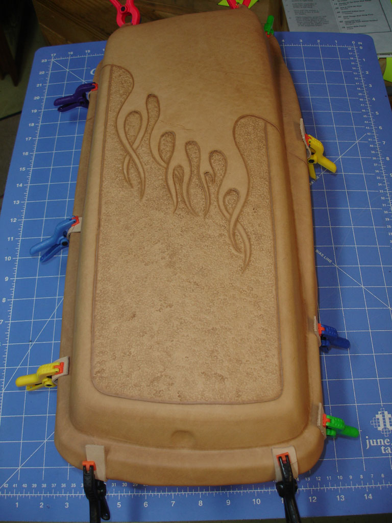

Today, I plan to mold one (if not both) saddlebag lid covers so I can finish the backgrounding and start punching holes while I mentally prepare myself for the stitching marathon I am about to embark upon!

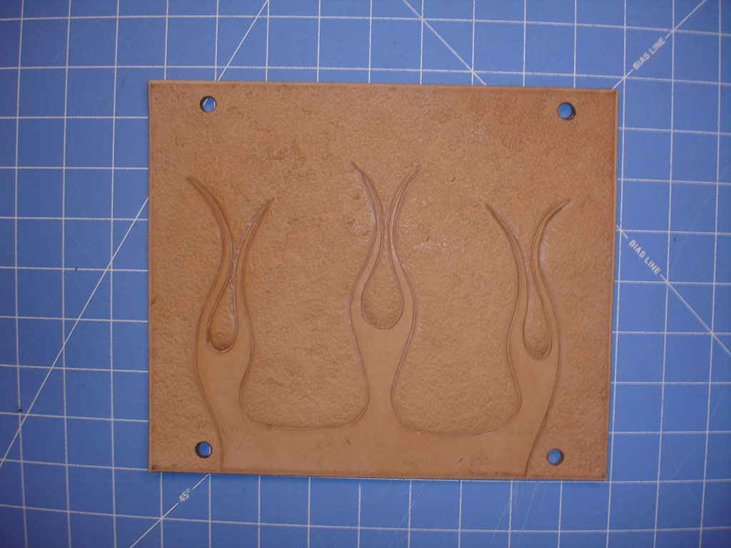

DSC00009.JPG I did manage to get the backrest done...
DSC00010.JPG and both saddlebag lids...
I haven't backgrounded the lid covers yet. I want to mold the lids then I'll know exactly where the lid edges are.... I only plan to background a small section of the lid cover. The rest of the bag is just plain leather with no carved details. I'm going to lace a design between 3 conchos on the sides... but that's a topic for another day....

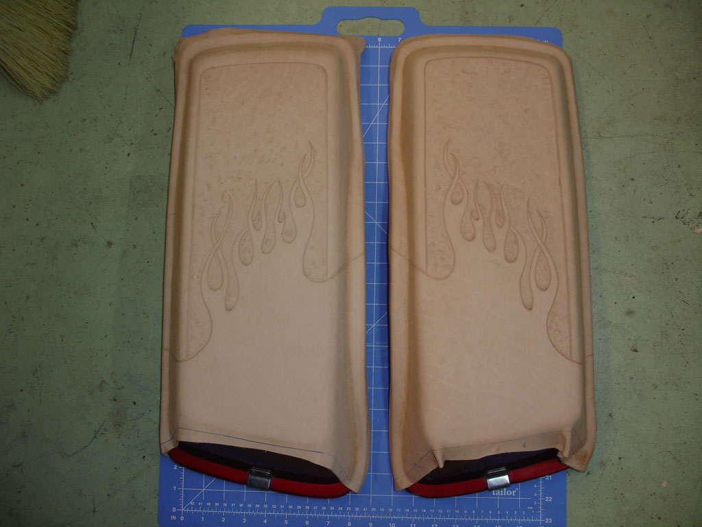

Well, as planned I was able to get one saddlebag wet-formed yesterday.
I'm really getting excited to finish this project. The customer wanted that "WOW Factor". I think he'll be pleased.
Edited by TroyS
Wow Troy!! Definetly that factor. It looks awesome.
Did you make a wooden plug or what? to mold it over.

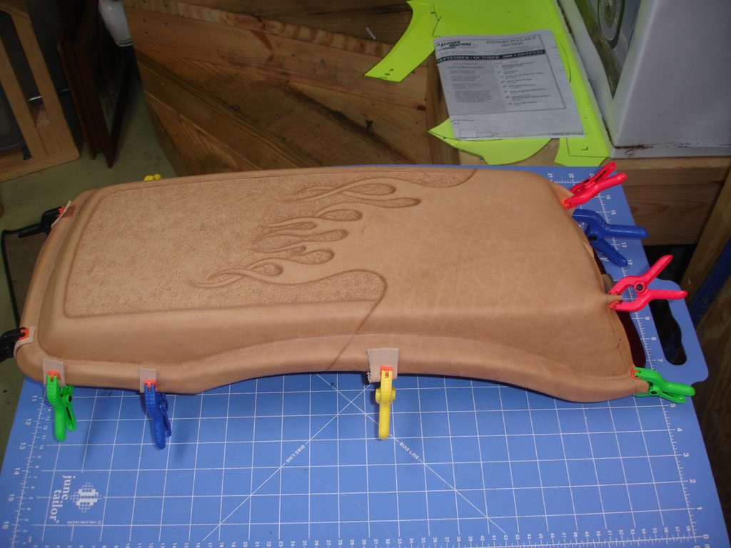

Ok, Update time...
Finished wet-forming both saddlebag lids and 3 of the seat panels before assembly...
The last picture is a rough idea of the final assembly... The seat panels are all in different stages of drying and will dry to same colors as saddlebags...
Oh yeah, the backrest is also wet-formed and waiting...
More as it develops...

That is looking great! I can't wait to see it finished. Why did you not form the front of the lids? What goes there, bottle holders?
ArtS
Good morning Art!
The front panels of the saddlebags are going to be sewn in place. I tried stretching the leather but there was too much leather bunched up there on a very visible edge. I'm going to stamp the background on those front panels to give protection to the front edge and also break up the pattern a bit ...

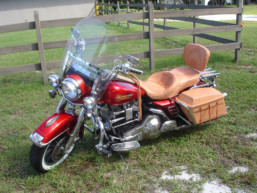

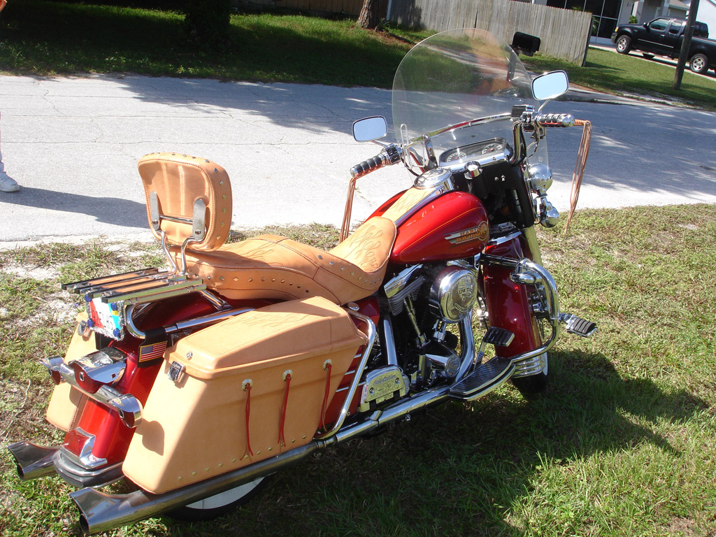

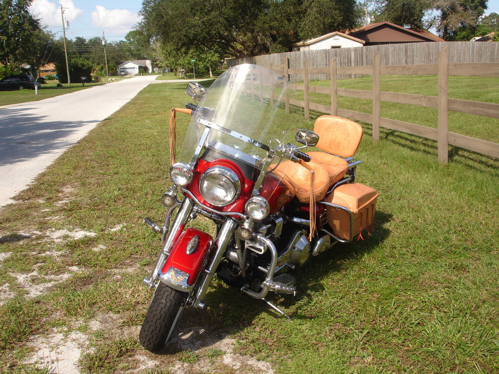

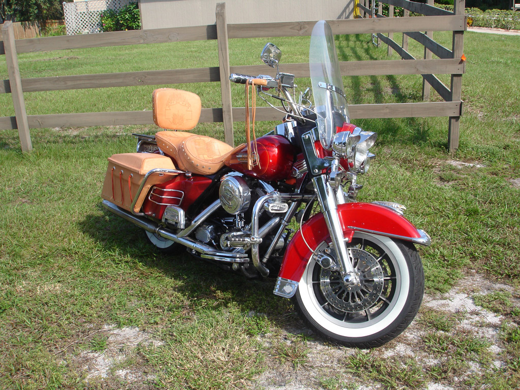

Well, I finally finished the wrap! Included are some photos I took... Let me know what ya think...
That is truly awesome!!!! That really came out great.
Love it.

hmmm, Here's some more...
Edited by TroyS
WOW bet he could buy a honda as a backup for what that setup is worth. very nice work and the owner will be stylin wherever the road takes him.
A+ looks to me like you have been very busy...... :red_bandana:
That's just awesome work.! Unbelievable amount of planning and execution nicely done.
