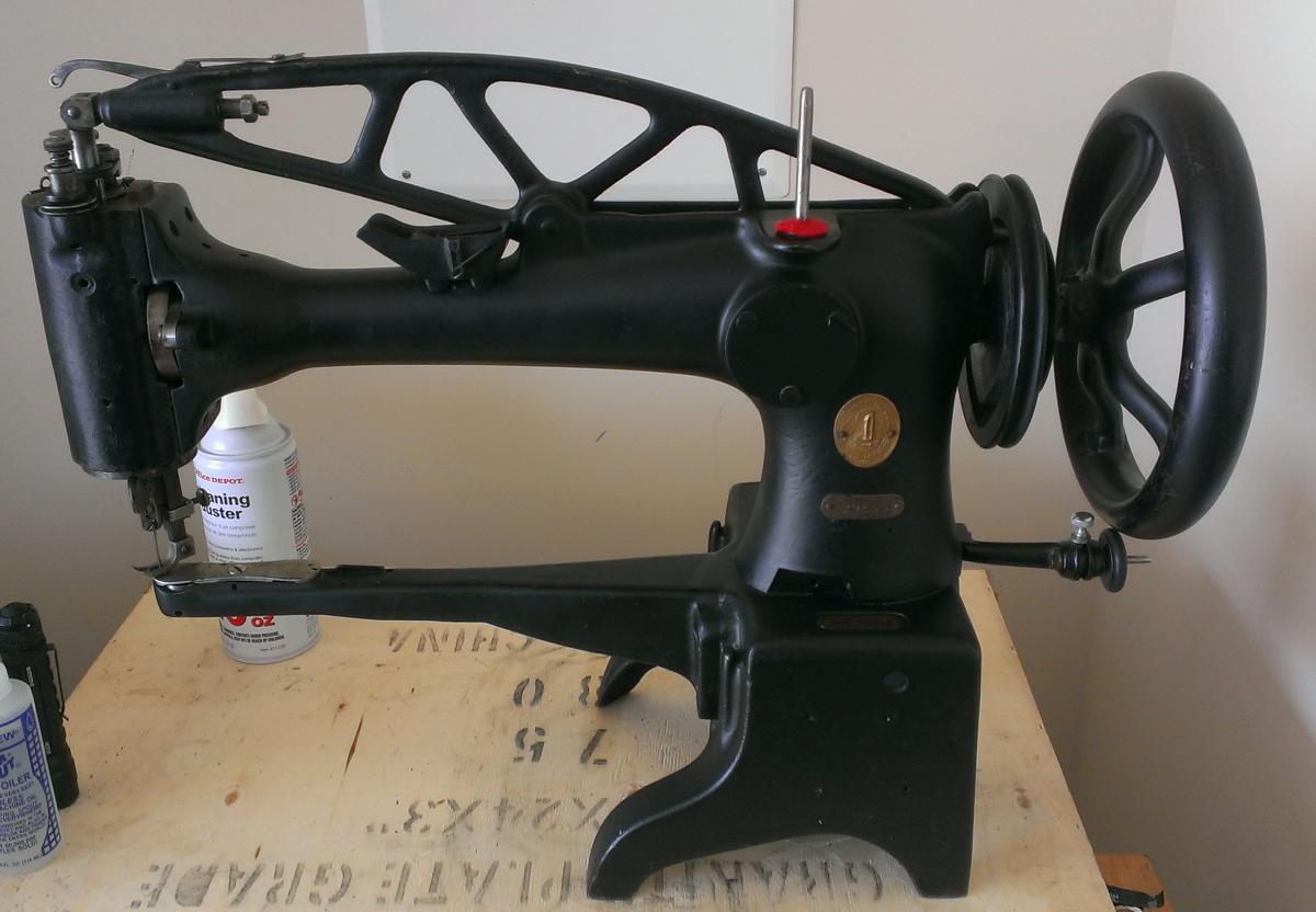

Members LeatherWerks Posted April 27, 2013 Members Report Posted April 27, 2013 Found a 29K Singer that I can get for a really good price. The problem is that it's just the head, no table or foot peddle to run the machine like I've seen on other 29K machines. Will the machine still work without the table or would it be a real pain to operate? Thanks, Steve Quote
Members oldtimer Posted April 27, 2013 Members Report Posted April 27, 2013 You can hand crank it Quote "The gun fight at the O.K. corral was actually started by two saddlemakers sitting around a bottle of whiskey talking about saddle fitting"...
Moderator Wizcrafts Posted April 27, 2013 Moderator Report Posted April 27, 2013 If you hand crank the wheel, you'll only have your left hand to guide the work and turn the presser foot. A third hand would be helpful to spin the wheel. Quote Posted IMHO, by Wiz My current crop of sewing machines: Cowboy CB4500, Singer 107w3, Singer 139w109, Singer 168G101, Singer 29k71, Singer 31-15, Singer 111w103, Singer 211G156, Adler 30-7 on power stand, Fortuna power skiver and a Pfaff 4 thread 2 needle serger.
Trox Posted April 27, 2013 Report Posted April 27, 2013 I always hand crank my 29K, it has a motor but I never use it. You can mount the machine on the end of your work table with the arm sticking out. You can also change the position of the hand wheel from back to the front or the other way around. Tor Quote Tor Workshop machines: TSC 441 clone/Efka DC1550, Dürkopp-Adler 267-373/Efka DC1600, Pfaff 345-H3/Cobra 600W, Singer 29K-72, Sandt 8 Ton clicking machine, Alpha SM skiving unit, Fortuna 620 band knife splitting machine. Old Irons: Adler 5-27, Adler 30-15, Singer 236W-100
Members LeatherWerks Posted April 27, 2013 Author Members Report Posted April 27, 2013 Okay, sounds like it's workable but not the best situation. If this machine works well and the person will part with it for 200.00 or so, I'll make the deal Steve Quote
Members Greenwood Posted April 27, 2013 Members Report Posted April 27, 2013 Hi Steve Like Trox I use the hand crank. I motorized my 29K60 by mounting a Dayton DC gear motor on the back of the unit. I fashioned a foot control pedal from a domestic Singer machine works fine it sews about 50-60 SPM at full throttle. Plenty fast for patching. I actually prefer the hand crank. I mounted the machine on a typewriter table, the kind that has retractable wheels so you can move around and move back for storage. These may be hard to find in the internet age. Dayton gear motors are not cheap, Check the web for prices. You may wish to consider getting a 1 amp motor and electronic pedal control from Cowboy Bob for about $100.00. This is the setup I have for my 31-20, works like a charm. I'm sure one could adapt a servo motor for about $150. There was no such thing as a servo-motor when I made the conversion, in hind sight thats the way I would go. Powerful and quiet. There are probably many other options, folks here are innovative and solve problems w/o breaking the bank. Good Luck Leo. Quote
Members LeatherWerks Posted April 28, 2013 Author Members Report Posted April 28, 2013 Okay, I bought this machine, Gave $200.00 for it. It seems to work okay but I haven't actually sewn anything yet. It is missing the rod that pushes the thread from the top down to the needle. I don't know what I could find to get the thread down to the needle, any suggestions? Also, does anyone actually make/have parts for these machines? I guess that's a slim chance since this machine was built in 1927. Anyway, thanks to all that responded to this thread, I appreciate the help. Steve Quote
Members Ken G Posted April 28, 2013 Members Report Posted April 28, 2013 Nice find. The bases do occasionally show up for sale on Ebay. There are currently two listed now. If you happen to be located in southeast Missouri there is one listed in western Kentucky. The shipping may not be too hateful if you can buy it right. Quote
Moderator Wizcrafts Posted April 29, 2013 Moderator Report Posted April 29, 2013 Okay, I bought this machine, Gave $200.00 for it. It seems to work okay but I haven't actually sewn anything yet. It is missing the rod that pushes the thread from the top down to the needle. I don't know what I could find to get the thread down to the needle, any suggestions? Also, does anyone actually make/have parts for these machines? I guess that's a slim chance since this machine was built in 1927. Anyway, thanks to all that responded to this thread, I appreciate the help. Steve You can buy the threading rod and all the replacement parts you need from Toledo Industrial Sewing Machines. Quote Posted IMHO, by Wiz My current crop of sewing machines: Cowboy CB4500, Singer 107w3, Singer 139w109, Singer 168G101, Singer 29k71, Singer 31-15, Singer 111w103, Singer 211G156, Adler 30-7 on power stand, Fortuna power skiver and a Pfaff 4 thread 2 needle serger.
Members LeatherWerks Posted April 30, 2013 Author Members Report Posted April 30, 2013 Okay, I called Bob Kovar at Toledo Sewing Machine and he had all the parts that I needed or just wanted to replace. Extra bobbins, a new foot, threading rod, needles and or course some thread. Prices we really reasonable. If anyone needs 29K parts, Toledo Sewing Machine is the place to go. Steve Quote
