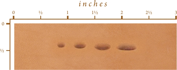

Members Harag Posted April 28, 2013 Members Report Posted April 28, 2013 Hi all I'm practicing some tooling/stamping and doing some celtic knots. I current have two lines about 2mm apart and I need to bevel in betwen them. The problem I'm having is that the bevel I have is so wide from front to back, so when I bevel down the side of line one, the back of the bevel flattens the other line, meaning I don't get a crisp bevel. I'm currently using the starting Bevel - B197 Can anyone recommend which bevel - or an alternative way I can bevel small areas? I've orderd a B935 which is about 1/2 the width, but the depth front to back is the same as the B197, so I'm going to have the same problem. A couple images of the current bookmarks I've done (first go BTW). http://www.mazdrak.c...rk/DSCF1580.JPG http://www.mazdrak.c...rk/DSCF1584.JPG Many thanks Quote

Members lightingale Posted April 30, 2013 Members Report Posted April 30, 2013 Definitely get some good sheridan bevellers. You won't BELIEVE how the quality of your work goes up with just this one tool upgrade. If you have some extra cash around, Barry King also sells some "concave" and "convex" bevellers, which I found useful at certain points of teeny tiny celtic knots. I've attached the concave and round beveller pictures from Barry King's website. Quote Salukifeathers.com
