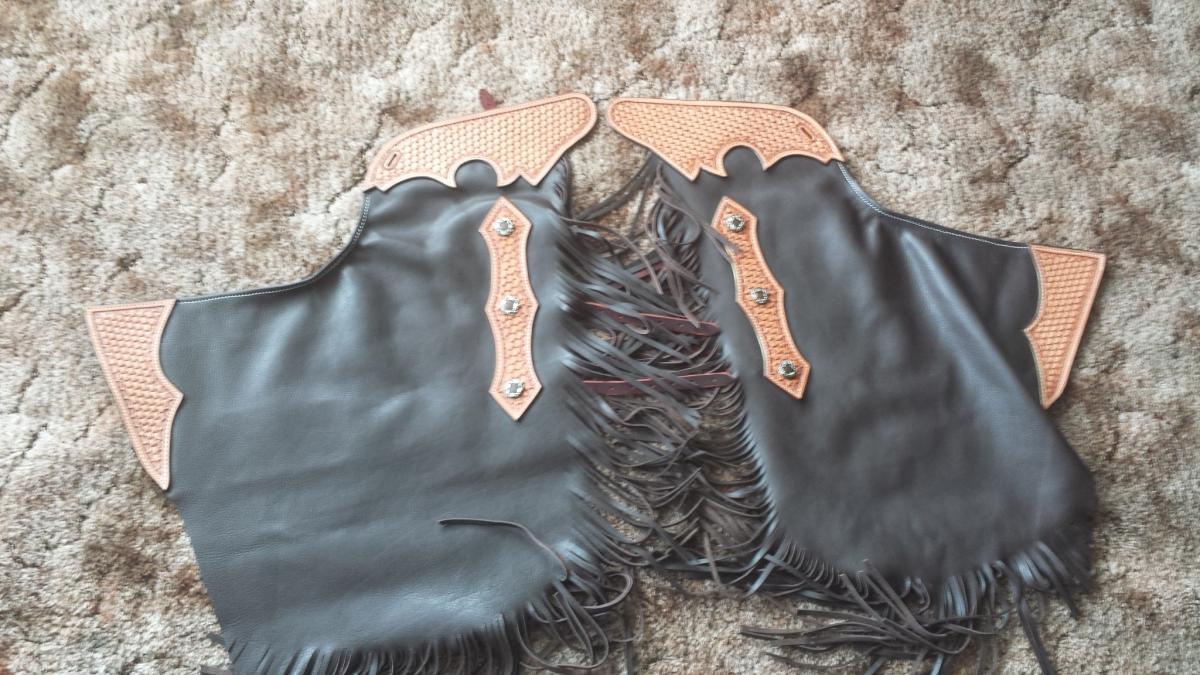

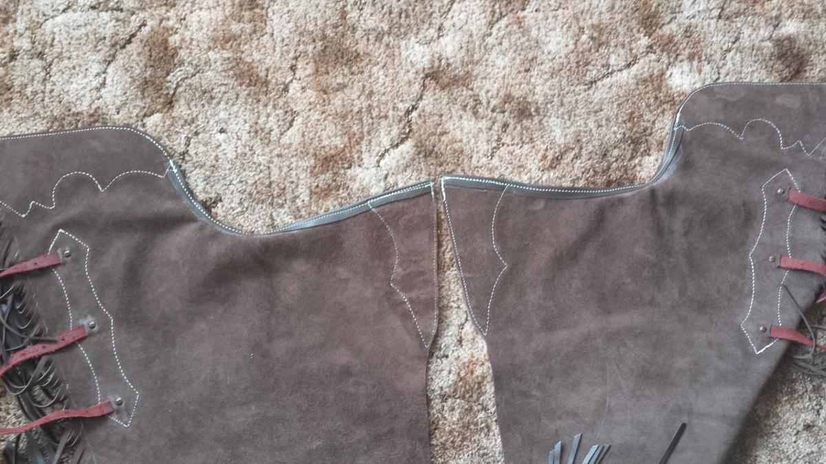

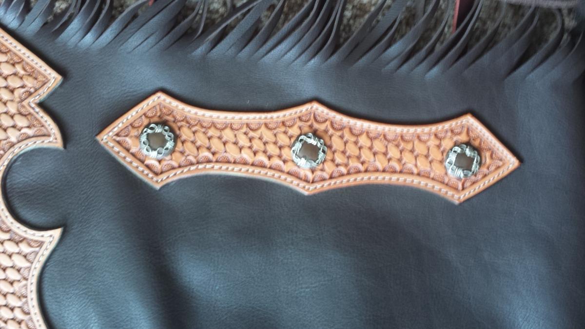

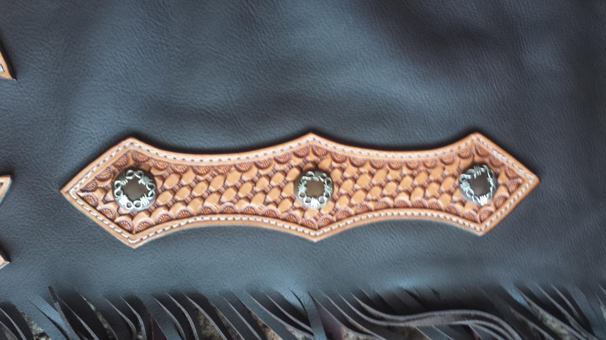

Here is my latest project. You can see some stitch length variation in sposts and how I missed the groove in a few places. The machine does pretty good! I just wish I knew how the stitch length gets off the way it does and how to fix it. This is with 207 top thread and bobbin. I got my 138 thread in the mail but have yet to try it out. Not sure I like the white color with this project, but that's another topic......

I know this isn't the show off forum but I'm open to critique/ help/ hints. Especially when it comes to machine setup.
Thanks guys!

Your square drive machine is not square driving, or else the needle is flexing too much. Check the needle feeding system for excessive slack. Make sure that the presser foot lifts completely off the leather until the feed motion comes to a halt. It must not be down as the needle is feeding.

Hi, not that bad. I see some errors mainly in conjunction with corners. A stitch can get loose when you lift the foot and during the advancing of the needle. Take car your needle is down and bit past B.D.C (so the hook has grabbed the thread) before lifting the foot. Try to increase the foot pressure and thread tension a bit. Did you find the stitch length regulator, to me it looks lite you can adjust the travel of the arm that moves side ways (on the back of the machine). I you get hold of a Luberto manual I am sure you can use it.
