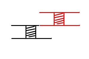

Members bizbeblu Posted June 23, 2013 Author Members Report Posted June 23, 2013 (edited) Somehow I missed the replies to my question. Sorry about that. I can see that my lighting needs to get a different angle. Mostly it is above and in front of me as the bench is against the wall with storage behind me. I'll play with it as it's still bothering me. Bob, Appreciate the lengthy reply. I spend a long time on the home row also, but don't always get it right. I'm often confusing the edge of the tool with the edge of the imprint which at least on Crafttools isn't the same. Maybe I need better basketweaves. If I get the drawing correctly, you're suggesting not putting the toe of the next (opposite) stamp completely against the center piece in the previous grove. Rather I think I'm seeing the idea that you pull it away from center contact by a small amount. How much I guess would depend on the size of the stamp. I confess to having a hard time remembering to set back over a long stamp period. I did pick up on the hint here that stamps weren't necessarily symmetrical. Silly me I've marked a corner so I'm leading with the same edge now. It does help. Thanks again. I'll keep playing with it. Robert Edited June 23, 2013 by bizbeblu Quote
Contributing Member Bob Blea Posted June 24, 2013 Contributing Member Report Posted June 24, 2013 Hello Robert, You are right that I am suggesting to not strike the next tool impression right up against the center bar of the previous one. Because we are human and can't space them perfectly each time, you need a little wiggle room between stamps to allow for variation. If you tried to stamp them right next to each other as close as possible, you would come to a point where you make a slight mistake and stamp one impression a bit off. That forces the next stamp to cut into the center bar of another basket weave because the one before it is slightly off. The problem will compound itself on each row that follows. Since we're all human and can't be perfect, it's better to give yourself some leeway and stamp the next stamp a slight bit over. The key is to make that distance consistent on every stamp, which is easier said than done. Once you do, your basket stamps will line up in neat rows in any direction. I haven't reached that Nirvana yet, so I still have a lot to learn! Bob Quote There are always possibilities.... Bob Blea C and B Leathercrafts Fort Collins, CO Visit my shop at http://www.etsy.com/shop/CandBLeather?ref=si_shop Instagram @bobbleacandbleather
