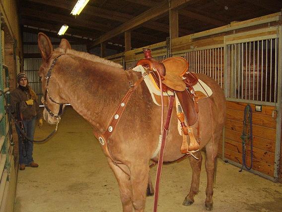

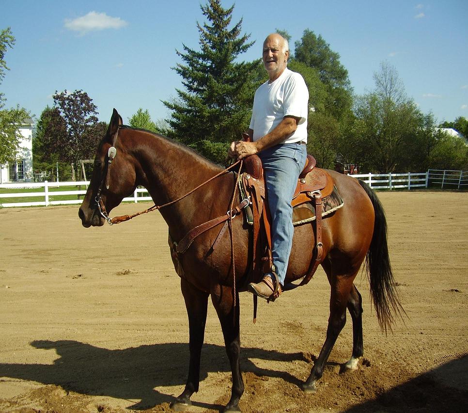

Aurelie, placement is as most have told you in their posts, a matter of preference, and need. Sometimes the type and build of a specific horse will dictate where they should be. Bottom line I have seen them in many places and seen different types of collars utilize different placings on the saddle. Here are a few pics of saddles that have the attachment in the skirts and you described, also a little higher and finally under the concho at the front of the fork. Each has it's own use. The high ones mostly are for pulling type collars like on the mule, the mid-high on the pic of the paint is because the owner likes to use a collar that has no tie-down going to the cinch. Again a matter of preference. The in-skirt shown on the Quarter horse and the Tennessee Walker is also a common and good placement. The key as somebody mentioned is that the collar when attached rides high and allows good shoulder movement without restriction. Hope that helps.
Bob
