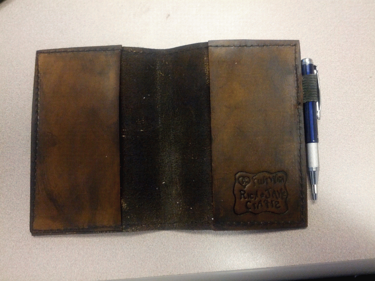

We are still getting used to our Tacsew T111-155. In making pocket notebooks (a cover with a pocket on each side) we are having trouble keeping the sewing lines straight. My wife thinks the issue occurs when thickness changes. In sewing the long edges she goes from 2 layers of leather to 1 layer then back to 2 again. And then in one spot we have an elastic loop sewn in as a pen holder.
Are there any tips or tricks of the trade for keeping lines straight when sewing around a rectangular project?
