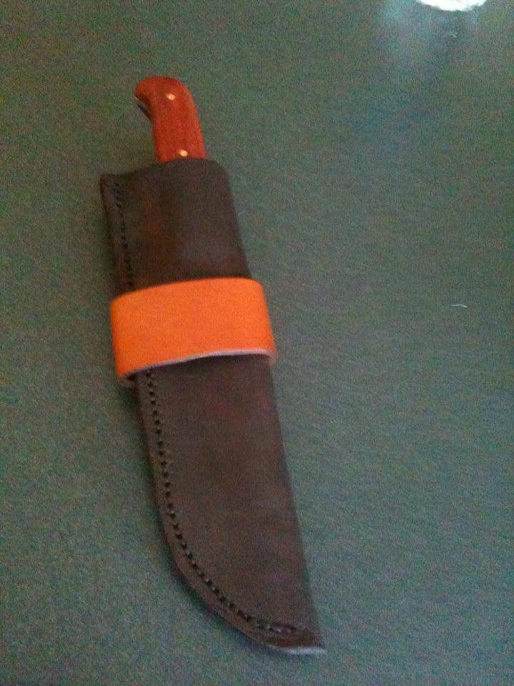

rawcustom Posted January 8, 2015 Report Posted January 8, 2015 A common method is to use a secondary loop around your sheath that your belt loop snaps to. I advise securing the secondary loop with stitching or a rivet otherwise they tend to fall off and get lost. If you're worried about retention than build it to use 2 snaps rather than one. Here is an example of what I'm talking about. Although you don't see the back side, you can see what I mean with the second loop around the sheath. Quote
Members vwaltman Posted January 21, 2015 Members Report Posted January 21, 2015 This is very similar to what I did as well on this sheath and I used 2 snaps on the cross strap Vern Quote
