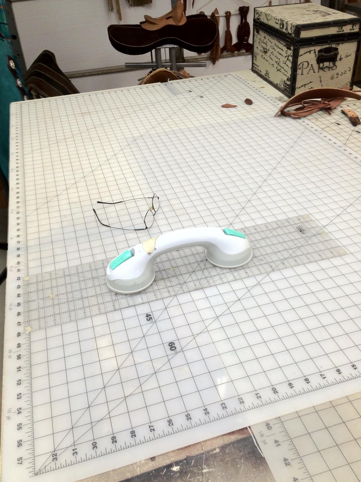

GrampaJoel Report post Posted August 1, 2013 Several years back my wife gave this to me. A shower suction handle stuck to a cutting ruler. I absolutely love it, and I use it at least once on every project. Quote Share this post Link to post Share on other sites
