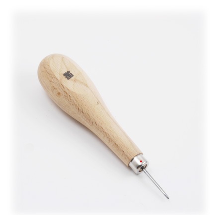

The thing that has helped me the most getting the holes at 45 degress is very simple. On the awl I have made a little dot with a magic marker. If this dot points straigth up then the awl is at 45 degrees
This pictures shows where I have put the dot. (not my awl)
