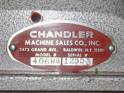

I just picked this up today. It a Chandsew 406RB from Chandler. I can find no "Made in XXXXX" so wonder who made this. I've heard Seiko, but wonder if Consew sold their 206RB through Chandler as a 406RB. The decal is in great condition, though the flash is washing it out.

An update of sorts: The motor for this Chandsew 406RB is dated: 1988. I was thinking the table might then be a replacement given what I was told was the approximate age of the machine.
However, I again noted the home-applied sticker below the Chandler plaque is the machine's serial number preceded by the number 87. I don't know the model sequence as it applies to the years of manufacture of these machines, but if I were to find that the sixties is too early for this, and that the eighties is just about right, then I have to think this is a 1987 Chandsew.
And it seems very clear that this is either pretty much an exact clone of a 206RB-1, or was made in the same factory, or is, in fact, a 206RB re-badged for distribution by Chandler, which I have to believe is a possibility.

I don't know the exact year but Chandler was bought by Consew approx. 8 yrs ago before that they were a separate company that imported a lot of different machines & were one of the first to bring Adlers in.All the parts from the early 206RB will fit in this though so you won't have any problems w/part.This machine may have been made in Taiwan.
This is my thought as well; looks like a Consew 206RB-2 (oil system), but I think it's a copy as well. I've seen a number of these at this point, a lot were brought in as an "Eagle" brand. If it is a Seiko/Consew 206RB-2 made in Japan by Seiko, Japan, it would have "SEIKO" embossed up under the bed behind one of the feed bars.
