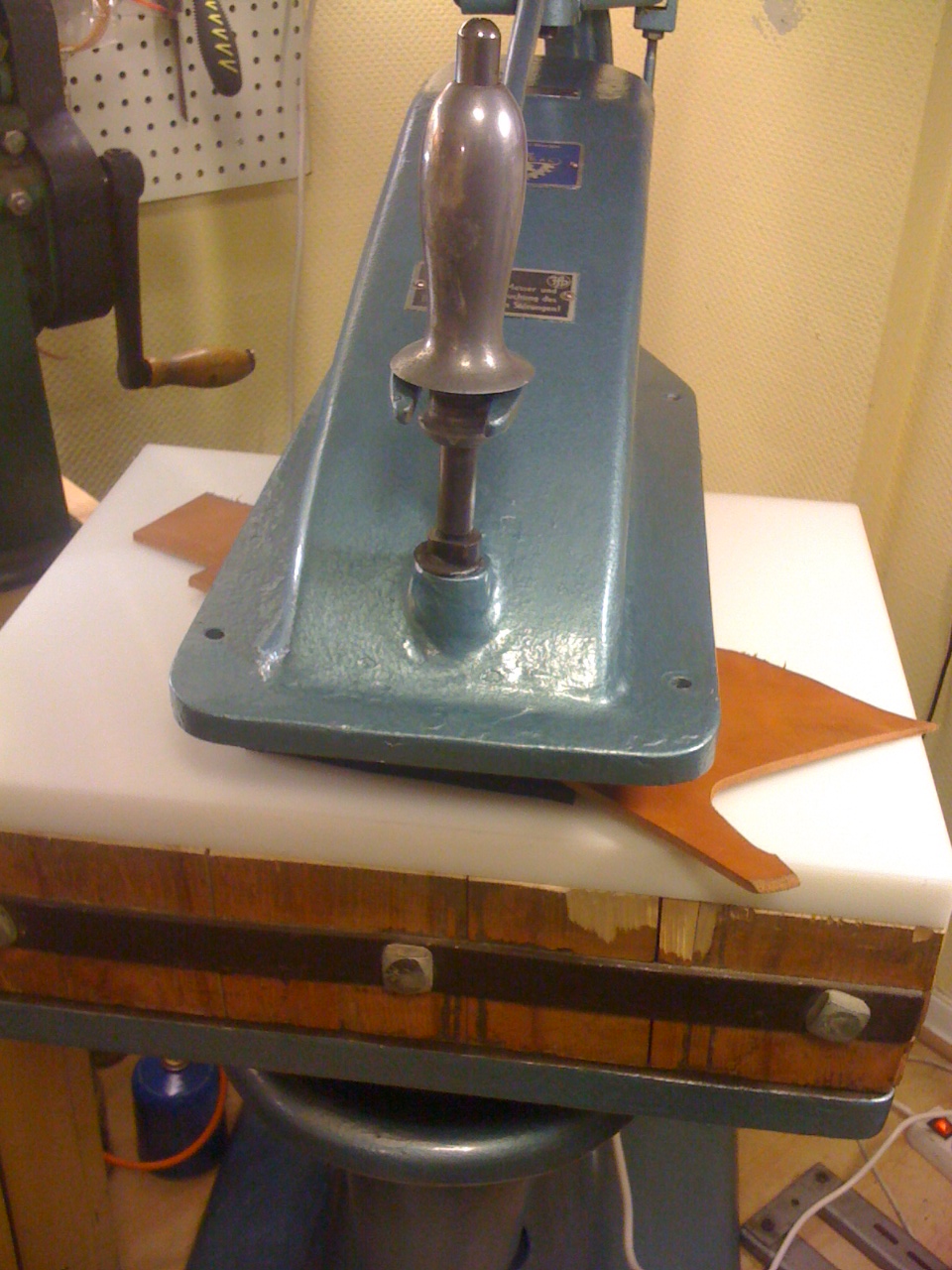

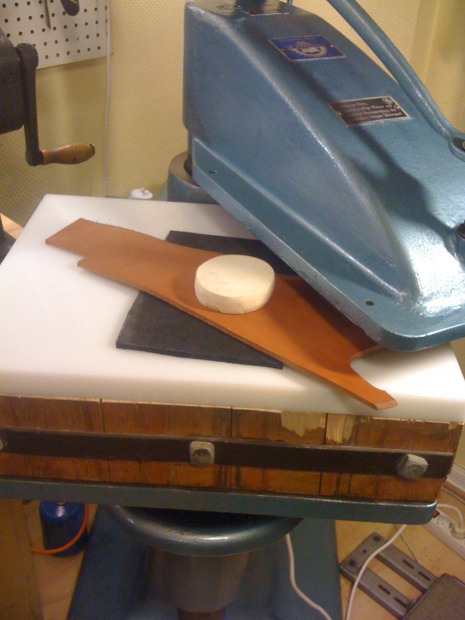

Depends of the price of course, its a electro mechanical press. And it might be hard to turn around when its been left outside. You should pour paraffin in all oil points and let it loosen up a bit before running it. I just restored an old German el. mechanical clicker. Its been left outside under a big awning during winter and summer time, and needed to bee moved around by force. I got it for free, but was willing to pay for it if I had too.
Its now working very well. You can get a great machine with a bit of elbow grease.
Before and after pictures
Good luck
Tor

Hi, it was Genava who paid 75$ for his machine , I got mine for free. The machine was for sale about three years ago for 6000 Norwegian krone`s (approx 1000 US$). I was about to buy it then, but my money went to other tools and machinery. I had forgotten all about the machine. Then three years later when cleaning up my email inn-box, I saw the mail again. And just for fun I checked if he have sold it. There are very few who do leather work in Norway, therefore he would not have many customers.
And it was kind of a sad story, he could not feed his family working as an saddler. He had done eight years of training in the UK before starting up his own as a bag maker here in Oslo, so then he had to close down. The machine stood outside his old workshop under a big awning ( during winter and summer time all that time). He said, if you still wants the machine you can have it for free if you pick it up. Lucky story for me, but not for him. he has a small leather shop in his basement, while working in a different job. I promised him a big discount on a heavy stitcher I have for sale, and he need one.
The machine did not turn easy around after standing idle for a long time, they normally do not rust inside. because there is allot of oil there. The oil becomes stiff, I had to pour big amount of paraffin (or diesel will work the same) inside all lube points, and force it to work again. Then I had to adjust the clutch mechanism, loosen it up. Then I rebuilt the motor to a single phase with two big capacitors to not loose any power. A coat with hammerite paint on the top. A other type of paint I got a tip on is car paint, several layers with clear top coat will stain all liquid including acetone (that loosen up hammerite)
When you start it you have to let the motor built up its rpm, then you pull the lever and "BANG" as a heavy hammer blow on a leather covered anvil. There is not that slow oils pneumatic sound but a shorter very powerful "BANG". Some of its powers comes from a very short stoke, I think about 20 mm or so. It has kind of a bicycle crank mechanism that transferee the power to the big column that drives the moving head. I think you will have the possibilities to get a very nice machine out of that. I do not think it turns easy after standing idle that long, thats why you will not get a video of it working, or perhaps you will. You can use it as a bargaining trump card to get the price down. You have to restore it anyhow.
Good luck
Tor
Tor
Workshop machines: TSC 441 clone/Efka DC1550, Dürkopp-Adler 267-373/Efka DC1600, Pfaff 345-H3/Cobra 600W, Singer 29K-72, Sandt 8 Ton clicking machine, Alpha SM skiving unit, Fortuna 620 band knife splitting machine. Old Irons: Adler 5-27, Adler 30-15, Singer 236W-100
