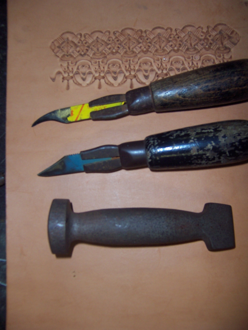

Davy Report post Posted September 28, 2008 Clicking Knives are the go . You can interchange the blades (I make mine from hacksaw blades) . If made right they cut like a razor . A wooden hand clicking board is best to cut on or other boards made from end grain wood will do . You can get the knife handles from a bootmaker supplier . Heavy leathers use a hook in blade , thinner leathers require less hook . Great for cutting around templates , eliminates marking out . Cheers , Dave . Quote Share this post Link to post Share on other sites
