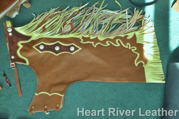

Timbo Posted September 16, 2008 Report Posted September 16, 2008 I have made my own chap patterns before...see some pics of my chaps on my website.......and I will agree with Bob that mods could throw things off.....but its not impossible. What I would do is to get the patterns and make a template from poster board from them and start modding from there. Sounds like you are only going to want to change them from the knee down so it should be fairly straight forward. I can't see what the backside of the leg does on his pic, but take your template and change the outside of the leg to be the way you want then bring the backside around and make the necessary adjustments to make it fit. Be careful though as sometimes mods can put a twist in the leg that you can't get with posterboard but shows up in leather. Also for that reason don't change the relationship of how the yoke goes onto the body either. That can make the chap legs do really funky things.......found that out the hard way. I like his patterns and believe I will also be ordering some from him as well. Especially that #34....and I am with your customer and not liking the bell bottom look too much either. I do like his chink patterns though. Hope I have been of some help. Tim Quote
