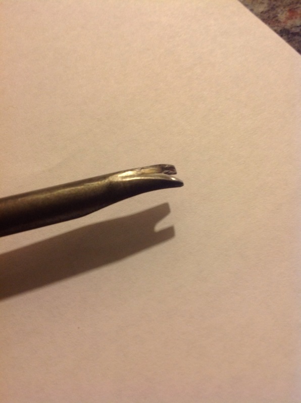

Contributing Member TwinOaks Posted August 31, 2013 Contributing Member Report Posted August 31, 2013 Here's some close ups so you can see the cuts. Quote Mike DeLoach Esse Quam Videri (Be rather than Seem) "Don't learn the tricks of the trade.....Learn the trade." "Teach what you know......Learn what you don't." LEATHER ARTISAN'S DIGITAL GUILD on Facebook.
Members gentle ben Posted August 31, 2013 Author Members Report Posted August 31, 2013 Picture says a thousand words! Thanks a million! Quote
