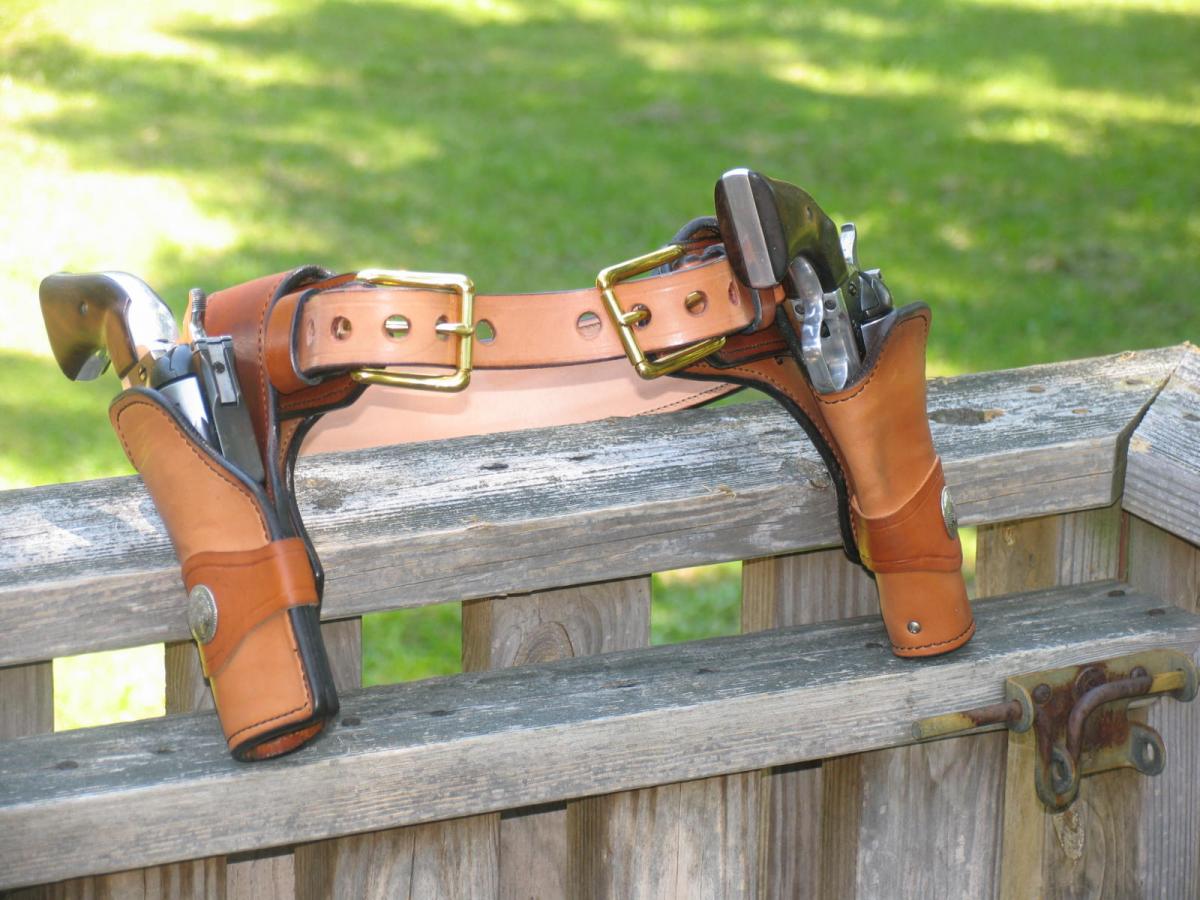

Members Red Cent Posted September 3, 2013 Members Report Posted September 3, 2013 Holsters are reverse sewn. Looked all over for someone to do this. Bob Mernickle, when I was really into SASS, made a rig for me. He wouldn't do it. Quote
Members Red Cent Posted September 3, 2013 Author Members Report Posted September 3, 2013 Put some dark brown edge kote on the rig. Looks neater. Quote
dirtclod Posted September 3, 2013 Report Posted September 3, 2013 Never seen anything like that before. I'm guessing you made them that way for a quicker draw ? Quote
Members Red Cent Posted September 3, 2013 Author Members Report Posted September 3, 2013 Dirtclod, I have to take you to a SASS match. Cowboy Action Shooting is one of the disciplines that require holstering your revolvers during the heat of the stage. I will roll the top edges out a little when I wet mold the holsters providing a big hole to hit when reholstering. And the reverse sew is different that accomplishes access to the trigger guard. And it helps with the draw. And, two strongsides like the above will require drawing the weak hand pistol and bringing it up and transferring it to the strong hand for shooting. The presentation from the weak hand to the the strong hand is acomplished if you can draw the weakhand gun with your index finger in front of the trigger guard, thumb on top of the frame, and the little finger hooking the grip. When you transfer the revolver, the thumb, the index and little finger is the only thing holding the revolver. Clean access by the strong hand. Dirtclod, your advice really worked. I had no trouble through two holsters and the belt. Thank you very much. Watch a cowboy shooter do the transfer to the hand in slow motion. Quote

Members Red Cent Posted September 4, 2013 Author Members Report Posted September 4, 2013 No, not really. Bob said it was a lot of work. Bob made me a custom rig a few years back. After that I met Bob in Las Vegas at the SASS annual convention. Matter of fact, Bob made another holster for me. I argued that it was too brief but, apparently, it sells. http://www.mernickleholsters.com/ca/CA23_23/ca23_23.html SASS rules leaves a lot of room for rigs. Paraphrasing, it says that any holster that reasonably retains the revolver during a match. Actually, the holster is rather easy to make. One of the big benefits is that you provide a sight track by the holster's shape. A small welt in the front would be easy if needed. This makes wet moulding easy. Quote

Members Red Cent Posted April 14, 2015 Author Members Report Posted April 14, 2015 Sent a few out. This is a couple of rigs. Quote
Members Red Cent Posted April 14, 2015 Author Members Report Posted April 14, 2015 Red Bear Haraldsson, you gonna try some reverse sewn holsters? Quote
Members Red Bear Haraldsson Posted April 15, 2015 Members Report Posted April 15, 2015 That I am sir, that I am. Thank you very much for the additional pictures you posted. Now, of course, I am dying of curiosity to know what that rivet is for, poking out near the barrel end of the holster. I was thinking of making mine a bit deeper to cover the trigger guard and use that 'web' between the guard and the barrel to put in a retention screw, but the rivet in your picture has me flummoxed. Quote
