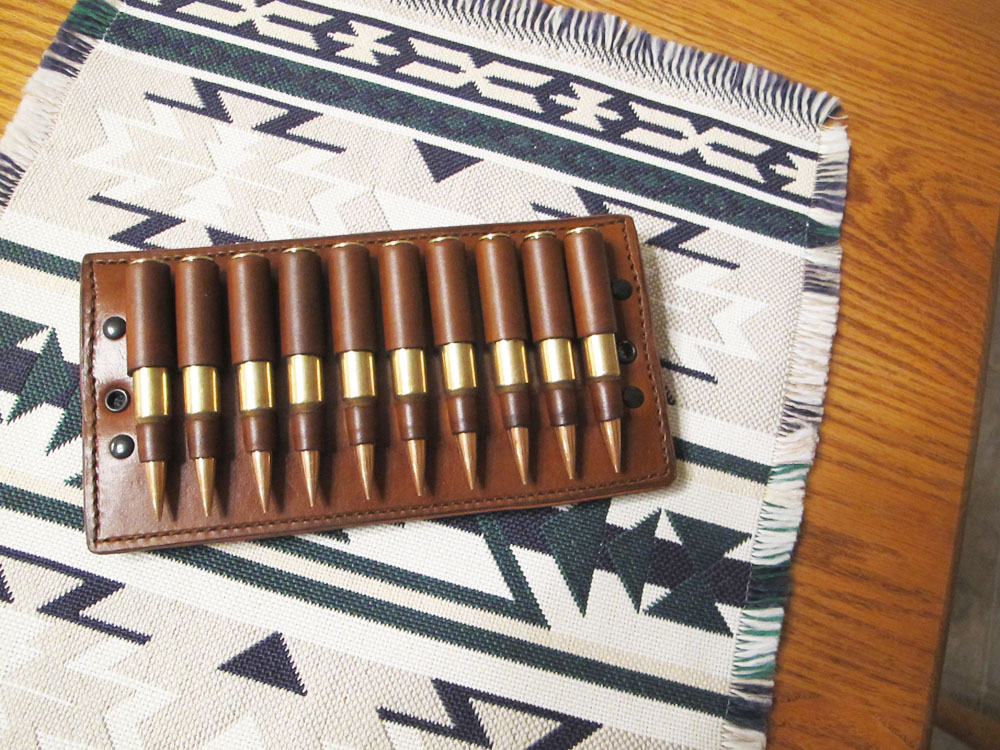

I've done a lot of these over the years for rimmed cases. As long as you secure both ends of the woven strip and wet mold (and allow to dry) the loops, they shouldn't move. Shotgun shells are doable, but you have to cut a pretty good size slot and end up with a potentially weaker holder. I prefer to stitch loops for shotshells. Rimless shells like many rifle cartridges work okay with two loops. A little more work, but much easier than stitching.
post-40965-0-33411300-1378739448_thumb.j

I really like that. Using the slot method makes it a lot easier to align the top and bottom loops than if you stitched them.
