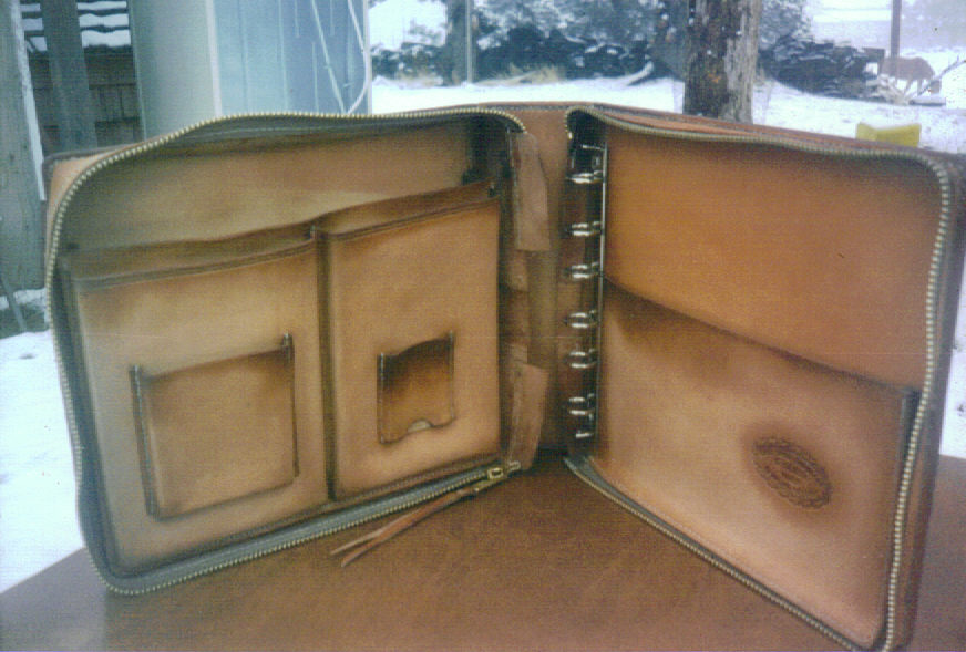

Members Hidemechanic Posted January 21, 2008 Members Report Posted January 21, 2008 1st ? what does sweety want to put in the binder? I 'm sure others may know a sourse for plans for making binders. Not sure what I used to do my first one years ago. I do have some pics depending how extravagnt you want to get. The simple ones you basically get the dementions you want for the item you want to cover. When closed you want to measure from the point that the pages attach at the ring, as the ring adds to the distance from the back of the spine to the outer edge of the page. I lay this all out on card stock first just make sure everything is working out. You want to measure the width of your ring and add a bit so the front and back cover don't leave ware marks on the inside from the rings. You want to find where you want your bends to be.Depending on the thickness of the leather you use you will probably want to use a gouge to make relief cuts for the bends. Decide it you are going to line the inside that will add a few more steps. As for attaching the binder, (you want to get a good quality one or it will fall apart on you pretty quicky) there is a special rivit you usually need to use or the rings won't hold right. You might be able to get a sample set of binder and rivits from Ohio Travel Bag but they normally sell that stuff in quantity. Someone else here may have ideas. As for the western theme, only your imagination will hold you back. I lost the picks of my last one but the front I tooled the well known circle with three Arabian horse heads. On the back I tooled a picture of the customer's Arab stalion head on an inside pocket I tooled a siloette of her stallion rearing on a masa. Did a bead and border stamp. The inside had card holders a clipboard clip for legal pad, a pocket for loose papers and pouch for glasses and whatnots and a couple pen loops on the spine, with a zippered closure. This lady sells adds for a country news paper she publishes and uses this for taking orders.This one didn't have a binder. The big one(circle 5) in the pics was for a contractor's business binder. Nowa days you'd add a pocket for a PDA or such. Hope this gives you some ideas. Sorry, forgot to resize the first one. GH Quote

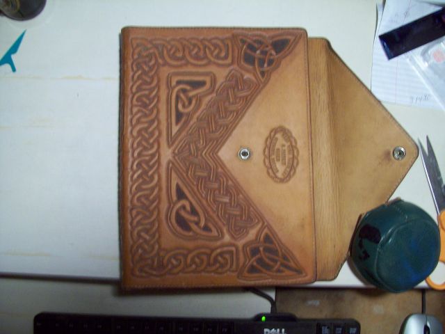

Members Hidemechanic Posted January 21, 2008 Members Report Posted January 21, 2008 (edited) Here's some more pics of an expirament gone wrong. This is one that I mis measured. With the ring binder in place the note book stuck out too far to close the cover. The expirament was the celtic carving, I wanted to see how it would look in leather as it was mostly done in stone in the early days. The ring binder is not in it cause I put it in a different cover.The slot in the left inside pannel is to slip the back of a note pad or reciept book into. binder_1.bmp binder_1.bmp Edited January 21, 2008 by Hidemechanic Quote

Members Hidemechanic Posted January 21, 2008 Members Report Posted January 21, 2008 Let's try these. Quote
