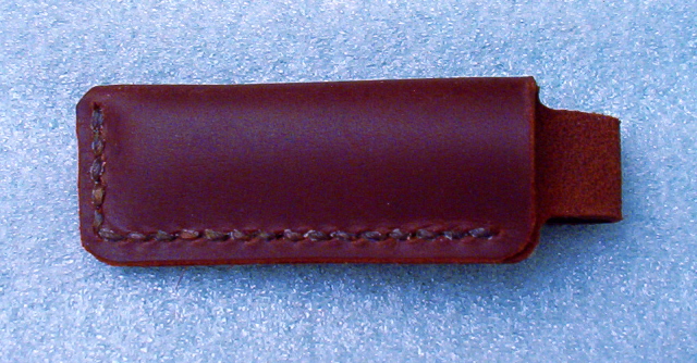

Members Tex Shooter Posted November 25, 2013 Author Members Report Posted November 25, 2013 I have made about 20 sheaths with these tools since I modified them and they are staying sharp and strong. Aaron is right though and I did not take too much off of the points for that reason. Here is a picture of the smallest sheath that I make using the largest tool only. It is for a 3 1/2 to 3 5/8 stock knife. I can cut and hand stitch 4 of these in about one hour. -- Tex Quote Tex-Shooter - Winner of the 2003and 2004 Summer Nationals Slingshot Tournament. -------------------------------------------------------------------------------- Too soon old/too late smart -------------------------------------------------------------------------------- “It is better to remain silent and thought a fool, than to open ones mouth and remove all doubt” Abraham Lincoln -------------------------------------------------------------------------------- My YouTube Channel ----- slingshotbill's channel - YouTube
