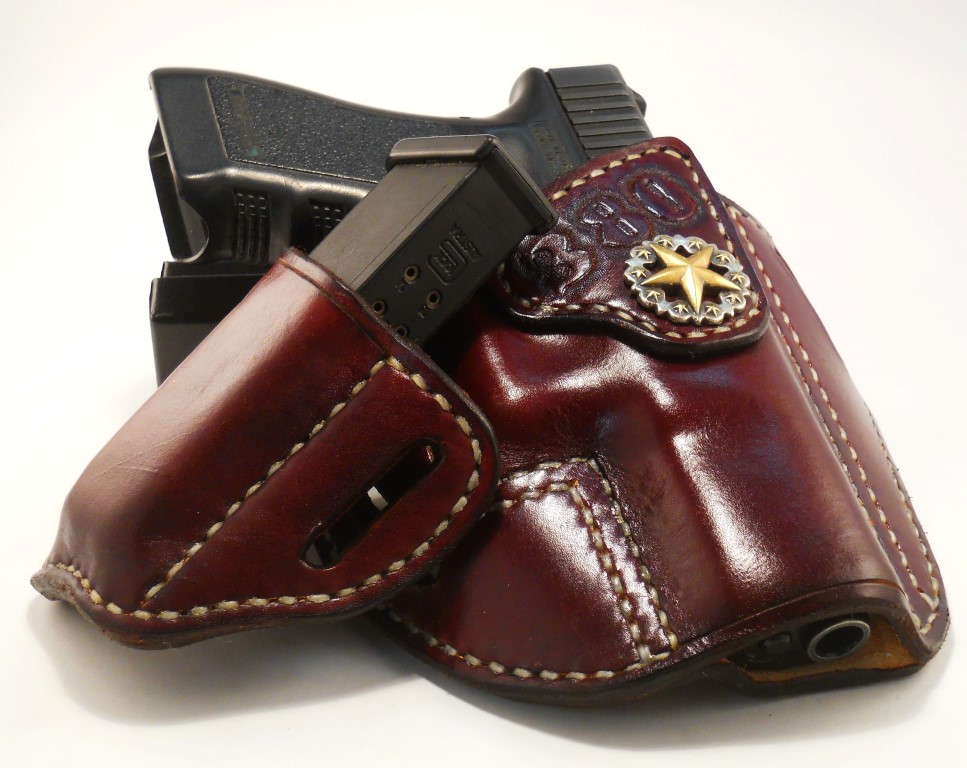

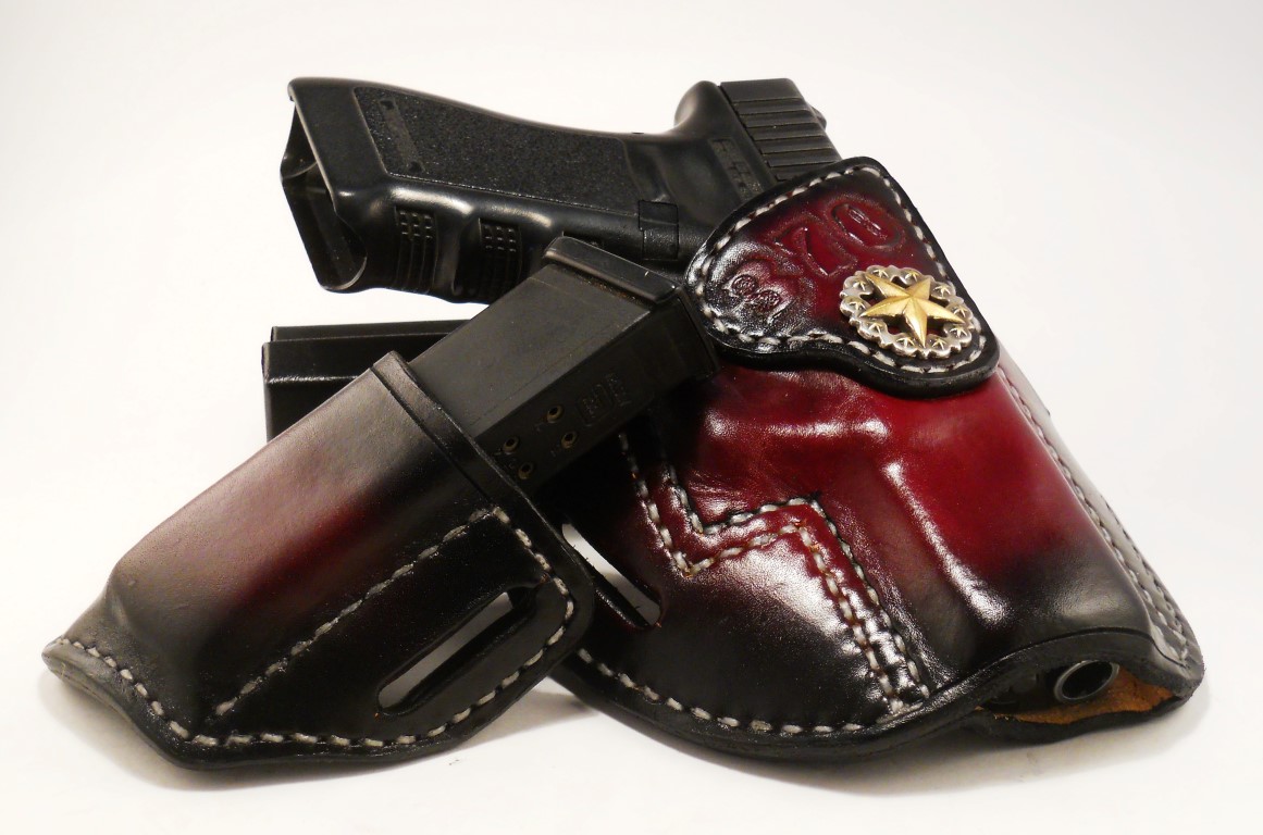

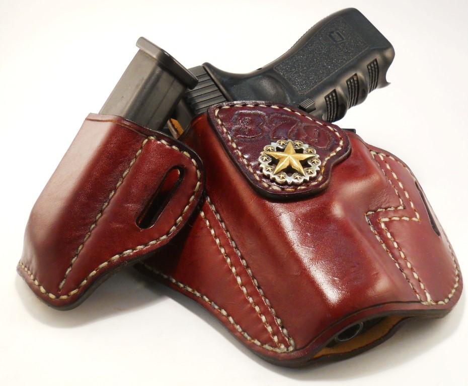

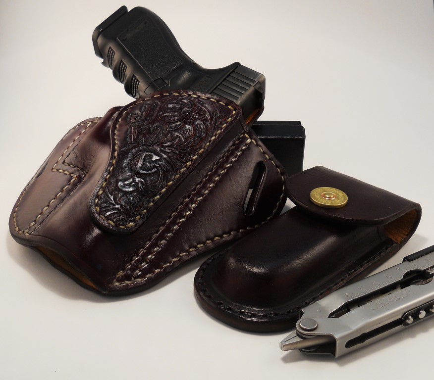

Just finished my first fairly large order. The one I made for the Chief Deputy really paid off. I already have two more in the queue and probably more to come once the other departments get a look.

Nice, you got the department looking good. I hope they appreciate how much work goes into making one of these beautiful pieces. You always post really good work. Take care!
Ralph
Good looking work Jack, they all turned out really nice...love the tooling on that last one...
Thanks guys. I was pretty pleased with them. I dropped them off this morning and they were thrilled. In turn I left with 3 more orders to start and several more they are going to call me about later:)
Those are beautiful! Very nice work!
Beautiful pieces of art! I like the forming on the pouch, it is perfect. I see the pouch thread color is different than the holster; are the holster and pouch a matching pieces or just pictured together. The thread on the holsters fill the channel very well and lays down nicely. What type of thread are you using?
Thanks vaalpens. The Leatherman pouch and holster were for the same guy, but not exactly a matching set. The smaller black thread just looked better on that pouch in my eyes. The black thread is the regular Tandy waxed nylon. The white thread is the Tejas waxed thread also purchased at Tandy. It is much larger and has a ton of wax on it. I cursed often when I first tried it, but since then, I figured out that I can heat a piece of it just a little with a heat gun and run it between a piece of canvas to take off some of the wax. After doing that, it has become my favorite. I plan to try some Barbour's 7 cord linen some day, but until then I'm pretty happy with the Tejas.

They all lok good!!.....just the stitchline around the trigger guard should follow more the contour of your gun.....you have some space there and if the glue finally loosen up you will have some play there.....just a thought!
Hey Jimbob, thanks for the comment. These Glock 22's have a square trigger guard in the front. There is no glue in there. In fact, I guess it's the angle that the pics were taken, but if you look at them straight on, the square trigger guard follows the stitch line. Must be an illusion from that angle.
