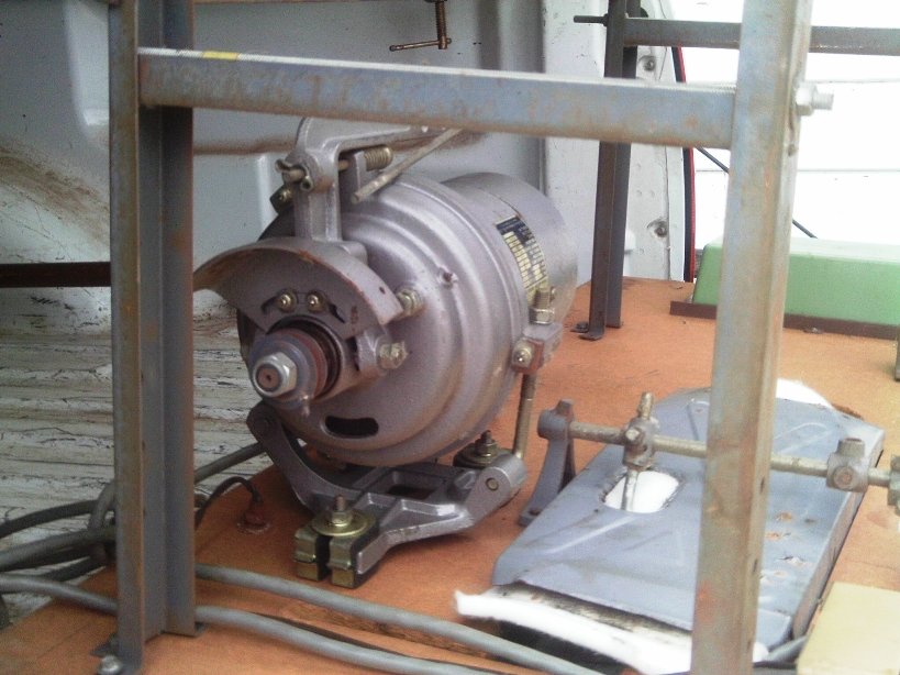

I have an H-leg industrial stand that has a Glaco Model PS-6 "Sewing Machine Transmitter" (clutch motor) on it. There was no machine in it when I got it, but the cut-out is good for the Singer 111-series machines. It's a 1725 RPM, 110VAC motor.

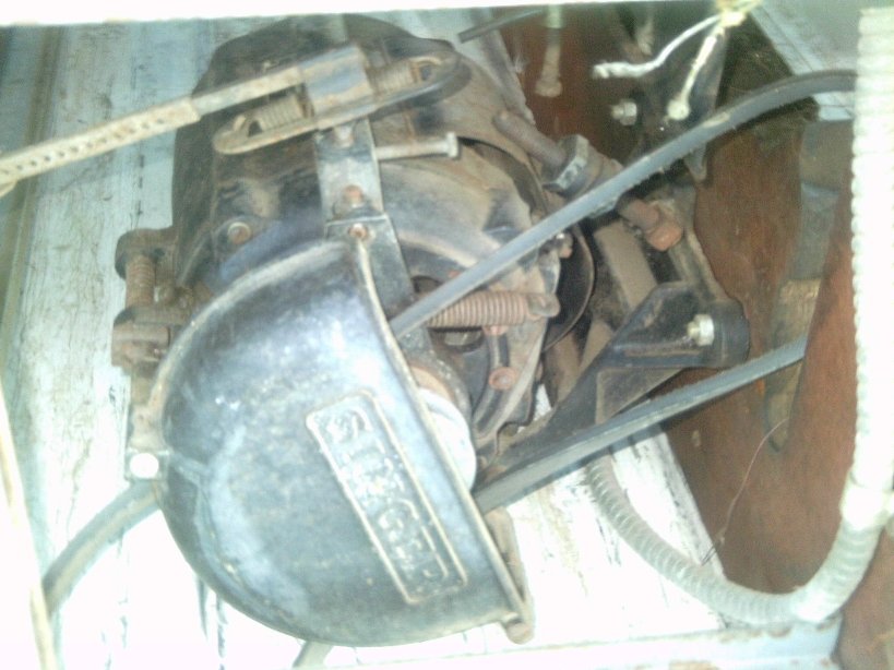

It came from a cleaning shop, so it probably had a fabric-sewing machine in it previously. Does anyone have any experience with this Glaco clutch motor pulling combination-feed machines for heavier work than fabric? Would it be as good or better than my Singer #S-463141 "Electric Transmitter" (clutch motor) that came to me with my Singer 111G156? It's a 1725 RPM, 110-115 VAC motor in a similar H-leg stand.
I can't keep them both, so I'm just trying to decide which one to keep and which one to let go.

That motor is rated at 2/5 H.P. which is a little on the low side for torque, depending on the material density and motor pulley diameter. If it has a 2" pulley, it will drive a standard walking foot machine, equipped with a #22 leather point needle, through a couple layers of belt leather.
Posted IMHO, by Wiz

Thanks Wiz. Of course the pulley size would matter, and I didn't give you that information. I can't get to them right now to measure them, but from photos I have of them, it looks like the Glaco may even be less than a 2" pulley, and the Singer appears to be about a 3"
Thanks for your input.

Keep the Singer, made in USA and a bit more powerful, keep the pulley off the other though, just in case.
Unless you have the space to keep both.
Just my .02 (overpriced at that)
