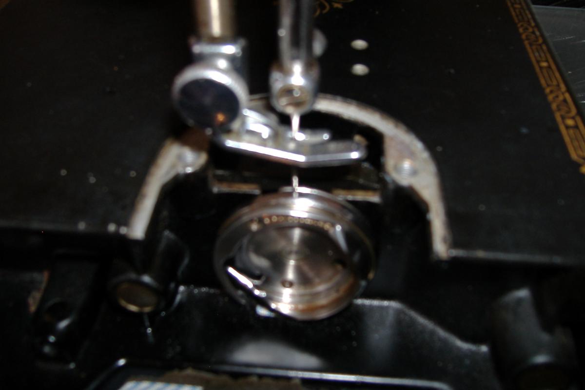

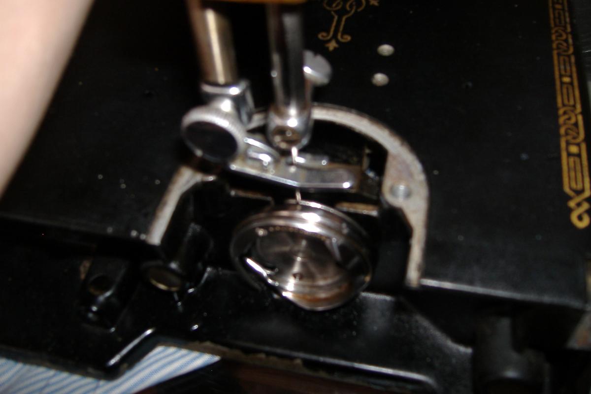

Members pux Posted December 20, 2013 Members Report Posted December 20, 2013 someone gave me a 1936 singer featherweight 221 took me a couple hours to figure it out how to use it, i manged to time the machine, it worked good for a short while but now 3 or 4 threads are coming out of the bobbin area and starting jams also the needle is rubbing against the other hook, just as the needle is coming up, how do i fix this? would grinding it fix it? Quote
