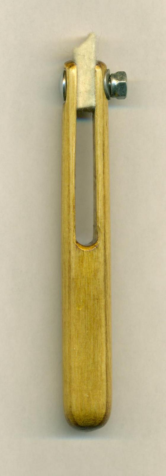

My applicator is one I made (see attached photo.). The tip is felt, cut on angle, so this should give me a little more edge control than a small wool dauber. Another help would be to minimize the amount of dye applied to the felt tip.

Cool Tool. I use a big plastic paperclip with a piece of felt to apply edge dressing. Same idea, but yours is slicker!!!
What did you use? a dowel rod

TomG..........Re photo of the dye applicator in my above post, below are some details.
Material : Hardwood Maple dowel
length overall : 4-1/4"
Diameter : 5/8"
Slot : 1/4" wide x 2-1/8" Long
Felt : 1/4" Thick x 1/2" wide x 7/8" Lg.
ToddB68
