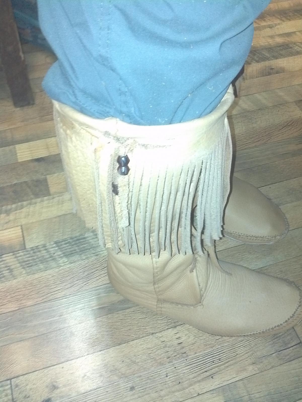

Here are a pair of tall moccasins i finished up for myself
Used 3oz Deertan for them with a 8oz inner and outer sole
I was wondering what weight/ type of leather is most common for the tall mocs, I see a few are using 8oz buffalo.

I'm not sure on the weight but I am officially jealous of your boots :(

Looks like you did a great job!
Posted (edited)
Thanks for the compliments, they turned out pretty good, I don't mind the working with the Deertan, Tandy pattern and I adjusted where necessary, Im thinking a heavier weight made a size of two bigger would possibly stay up better and allow for a liner.

just out of curiosity, how many square feet of material did you use?
Every day you learn something is a good day. If you don't learn something every day, was it worth waking up for?
I used 12 sqft for a size 10, and punched 1952 holes for stitching not that I counted..:blink:

that's ummmm a lot of holes lol but you've inspired me to seriously look at making a pair for myself
I used a lacing chisel with 4 prongs and set it in my Arbour press.
Set a marker line for the stitch line and away i sat ,:wacko:
Drew the pattern and numbered the sections of it with the amount of holes, to keep everything lined up, I also used a 5/64" hole bunch to mark the starting points,where I wanted to start and stop stitching the sections. and as marker points for alignment, It helped me keep everything align, especially my inner peace.. :thumbsup:

ok, guess I know what I'm doing this weekend :) hopefully mine will turn out as nice as yours and I still have what little hair I have now when I finish :D
