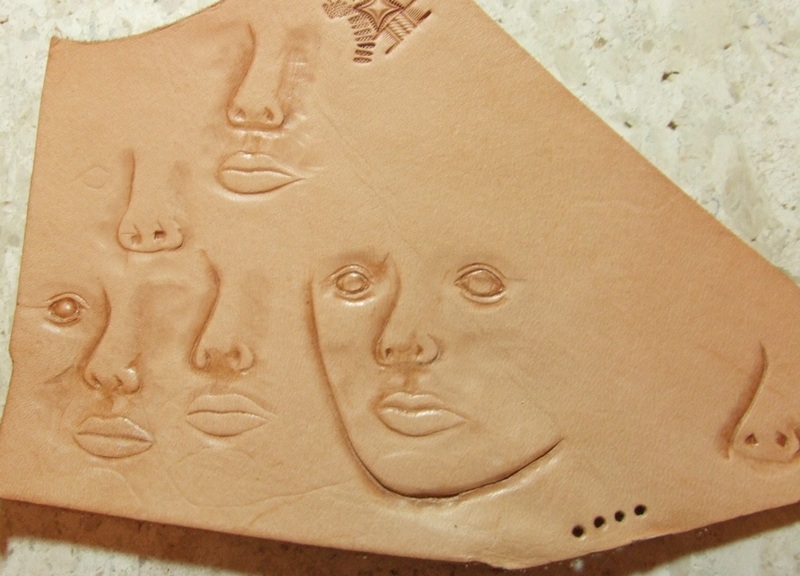

Knew the sensible thing was to post pics of what I tried, but.................pretty embarrassing efforts (even more so now you've posted your 1st effort :blush: ) so I'd put it off.
Crappy pics as well - nearly midnight here so artificial light. 1st (double) pic was my 1st attempt a little while ago - realised I had a problem & put it off for a few weeks. The noses were what I did 2 days ago & were sort of a sketch & almost me scribbling over a couple with frustration (silly beveling under nostrils).

I don't think your that far off. If you take away the shading on the tattoo it would look snoutish also. I think you may be cutting to far under the nostrol, instead of beveling there use your modeling spoon to burnish a shading to create the 3d illusion, same for the bridge of the nose on the uncut side. I learned with Al Stolmans figure carving finesse book also, he has several faces with good instructions in there. That was my first attempt of trying to do a complete carving, I practiced a couple of days with scrap pieces much like you've done. Good luck Troy
