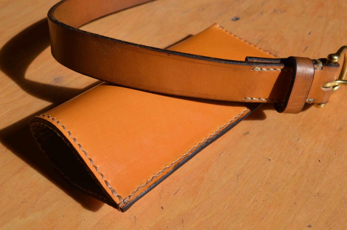

London Tan is quite a historical color in both saddle and casemaking trades, it was only used around the city in the times of the Walsall heyday. It is by no means yellow, but a tan with minimal reds and browns. However, when it ages the yellow does fade as the russets become more dominant. It is a striking color at any stage I think.
These two images of the same photo may shed light on interpreting London color.
They show a strap having taken some substantial wear and an unused glass case, one image highlighting russet, the other, yellow notes.
