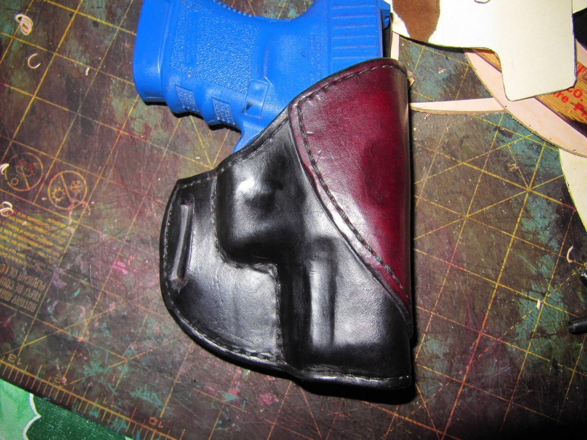

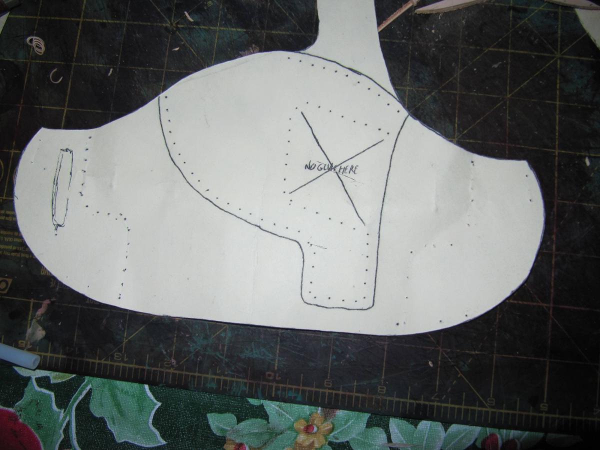

camano ridge Report post Posted March 12, 2014 Are you using a ready made pattern or is this your own design? If it is a ready made pattern then cut the pieces as specified by the pattern when you asseble everything will work out. If this is your own pattern draw the pieces so they fir together as you want them with the leather laying flat. Here is a you tube video that may help https://www.youtube.com/watch?v=VUor11Eeq5Q. I highlyrecomend going to Adams leatherworks and watching his videos on making Avenger style holster. They will cost you a few dollars to watch but are well worth it in the time and leather you will save. Here are some pictures that might help. THe first one is the main body pattern. The second is the re enforcement piece aligned flat on the main body. The third picture shows the two pieces folde and not aligning (so don't fold). The fourth picture shows the holster I completed yesterday from this pattern. SO when your two pieces are layed flat and aligned that is when you glue and stitch. worry about folding after the two pieces are attached to each other. The tention of the two against each other is what forms your pocket. Hope this helps. Excuse the photography I just clicked a few pictures as demo for you. Quote Share this post Link to post Share on other sites
