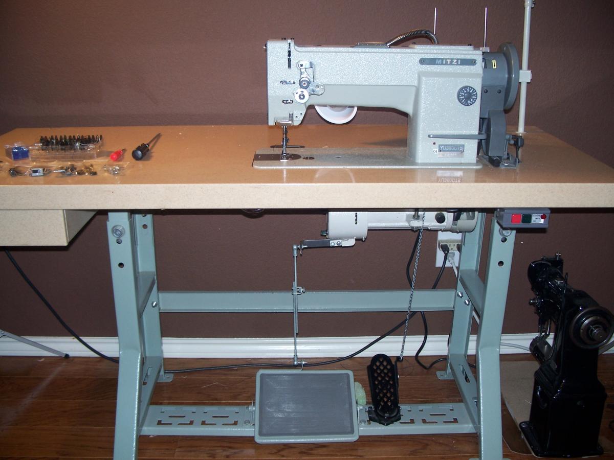

I have the same machine as a Cobra Class 18. When I slow down to a crawl or try to handwheel the machine it wants to pull the knots to the top. If I stop in the middle of something it will always pull the knot to top. Any advice would be greatly appreciated. Thanks Tim

Sounds like too much top tension.
What size needle and thread are you using, how thick is the leather, pictures of the stitching top and bottom will help.
If it was sewing properly at one time then it's likely just a tension problem.
