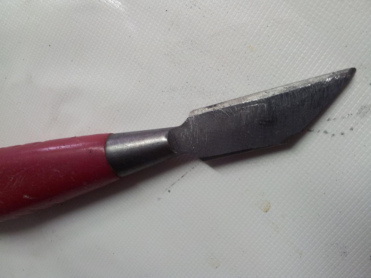

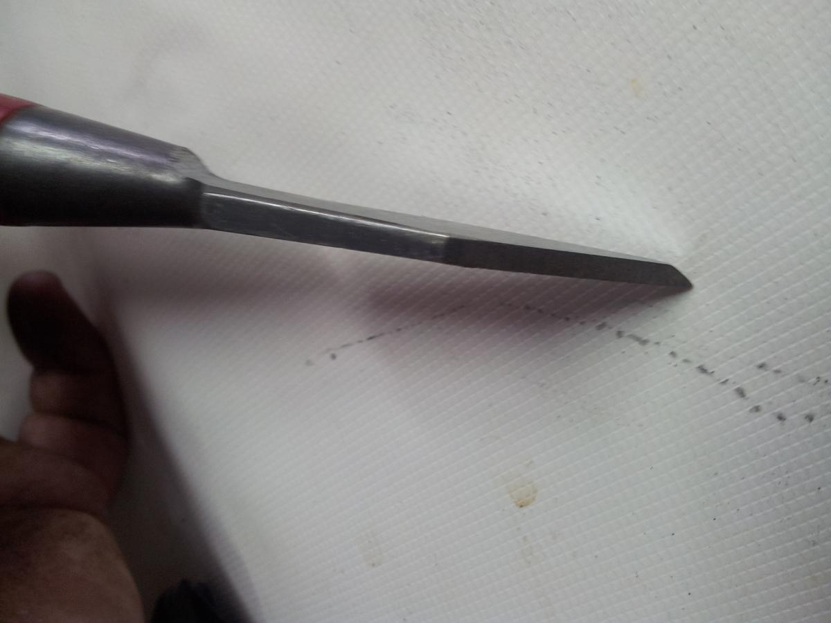

Members dirkba Posted April 13, 2014 Members Report Posted April 13, 2014 (edited) This project was inspired by the forum. I decided to try my hand at making 2 tools I desperately needed. At a second hand tool shop I bought an old worn down wood chisel and an arbor. (Spade drill bit) These were to become a set of skiving knifes. I hope the pictures tell the story, because I am now the proud owner of these self made durable work pieces. Cheers Dirk Edited April 13, 2014 by northmount Spade bit Quote
dirtclod Posted April 13, 2014 Report Posted April 13, 2014 Neat ideal and nice work. I'm going to try my hand at the spade bit skiver. I have been using a box plane blade to skive with and it works pretty good, but it's a little bit wide to hold and use very much. Quote
Members dirkba Posted April 13, 2014 Author Members Report Posted April 13, 2014 Hi Dirtclod, Cut the tapered edge of the spade bit of or else the handle is too long. Good luck Dirk Quote
Members TomG Posted April 13, 2014 Members Report Posted April 13, 2014 What's the wooden block used for? Quote
Members WyomingSlick Posted April 13, 2014 Members Report Posted April 13, 2014 Applause for your can-do attitude. Your oupa would be proud of you. Quote
Members dirkba Posted April 14, 2014 Author Members Report Posted April 14, 2014 Hi Tomg, The block was shaped on a belt sander to form the handle on the spade bit. Cheers Dirk Quote
Members silverwingit Posted April 14, 2014 Members Report Posted April 14, 2014 I've thought about doing this, but I have held off because I don't know how to grind the metal to a fine edge without negatively impacting the tool's temper. I wonder if you are at all concerned about ruining the temper on these blades by grinding them so heavily? Or perhaps you have a technique that avoids this problem. If so, would you mind sharing it? Thanks, Michelle Quote
Members Feraud Posted April 14, 2014 Members Report Posted April 14, 2014 Nice result. It is very creative and inspirational, not to mention cost effective! This is going on my mental "to do" list! Quote
Members dirkba Posted April 14, 2014 Author Members Report Posted April 14, 2014 Hi Michelle, The tempering was not an real issue as these tools are doing "soft" work cutting into leather. However I did cool the steel down, by dumping it in cold water, while grinding away. Remember that the steel is not really that thick to start of with. So it really cools down quickly by submersing it in cold water. Give it a go!! Quote
Members silverwingit Posted April 14, 2014 Members Report Posted April 14, 2014 (edited) I was thinking more about holding the edge you've worked hard to achieve. Yes, quenching in water is a good idea. I do believe I have a couple old chisels to have a go with. Nothing to lose, right? Thanks for pointing the way, Dirk! Michelle Edited April 14, 2014 by silverwingit Quote
Trox Posted April 14, 2014 Report Posted April 14, 2014 Hi Dirk, nice job. Although I have enough skiving knifes, I am always on lookout for high speed steels that could be made in to good knifes. The wide wooden drill bit was a good idea. And it turned out looking good too. It also have a hole in the blade to hang it on the wall; very nice. Hi Michelle, if you use high speed steel like used in drill bits and hacksaw/metal saw blades, U can heat them very much without ruin the tempering. (Bi metal is not usable, look for hs or hss markings) I use a cheap bench belt sander for the grinding/sharpening of my blades. It runs very cool all the time; I normally do not need to use any water to cool down the steel. I use normal wood belts (because that's the only I find for it) 80 and 180 grit. When the belt is almost worn out it gives an almost polishing effect. Then I use a buffing wheel (with buffing/grinding compound) for the polishing. Thanks Tor Quote
Members dirkba Posted April 14, 2014 Author Members Report Posted April 14, 2014 Hi Trox, Thanks for the technical input. I used a standard bench grinding wheel to do the rough grinding - hence the need for water. The finer touches was done on a belt sander with 80 grit. I watched closely for any signs of discoloring that would indicate the steel is too hot. These tools were never intended to be sold so I am not so much concerned with a spotless end result that is honed and polished to perfection. I need a cost effective working tool. Quote
Members StrigaMort Posted April 22, 2014 Members Report Posted April 22, 2014 (edited) Hold the work near where the grinding is taking place. When it gets too warm to hold comfortably, dip in water. If you see colors form, you've altered the temper. Always use sharp (new) belts. Zirconia belts can usually be found easily. They are the blue ones. Much better for steel grinding than aluminum oxide (wood) belts. If you need to remove a lot of hardened steel,use a low grit (36, 40 are good). Higher grits, and worn belts produce more heat. I'd do the final sharpening by hand, on stones or SiC paper. If you really want to make a better blade, start with good annealed high carbon steel. A 4' stick of 1084 is very inexpensive from Aldo (newjerseysteelbaron.com) and is eutectoid steel. Heat with a torch just past non-magnetic and quench in canola oil. Throw it in the oven for two one hourtempering cycles at 400° and you'll have a world class blade. Sounds harder than it is. If you have a belt sander and the ability to craft leather, you can grind out a fantastic blade. Let me know if I can help in any way. Edited April 22, 2014 by StrigaMort Quote
