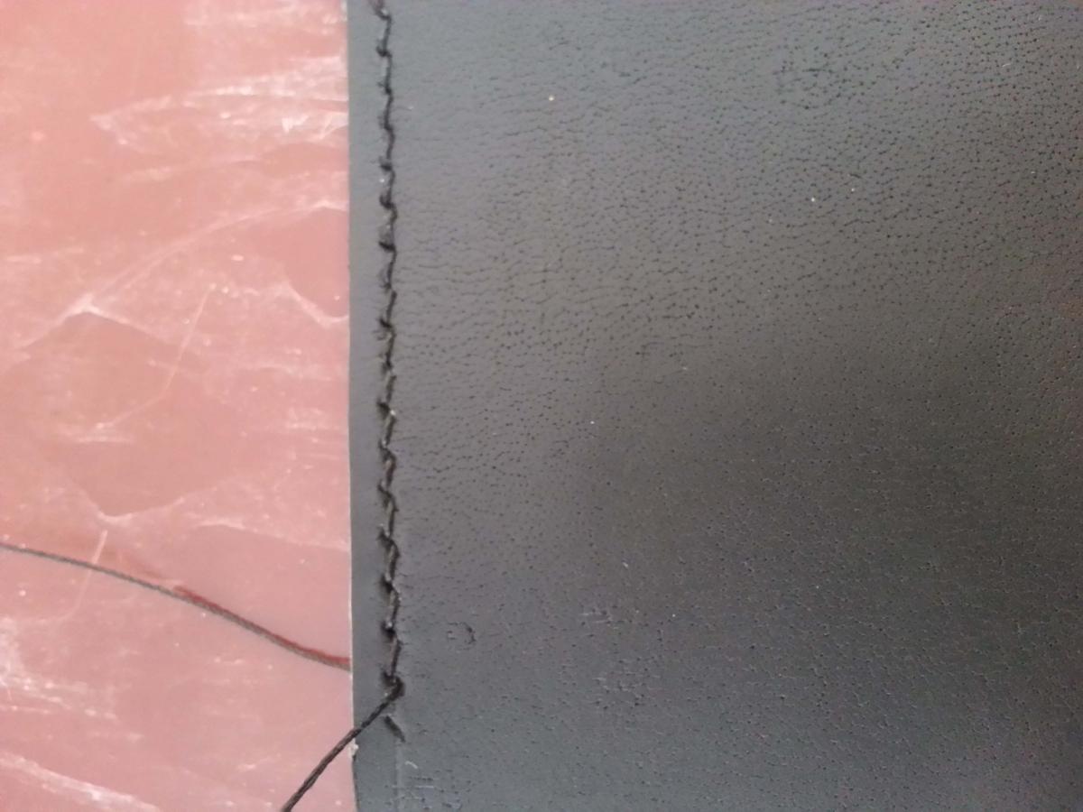

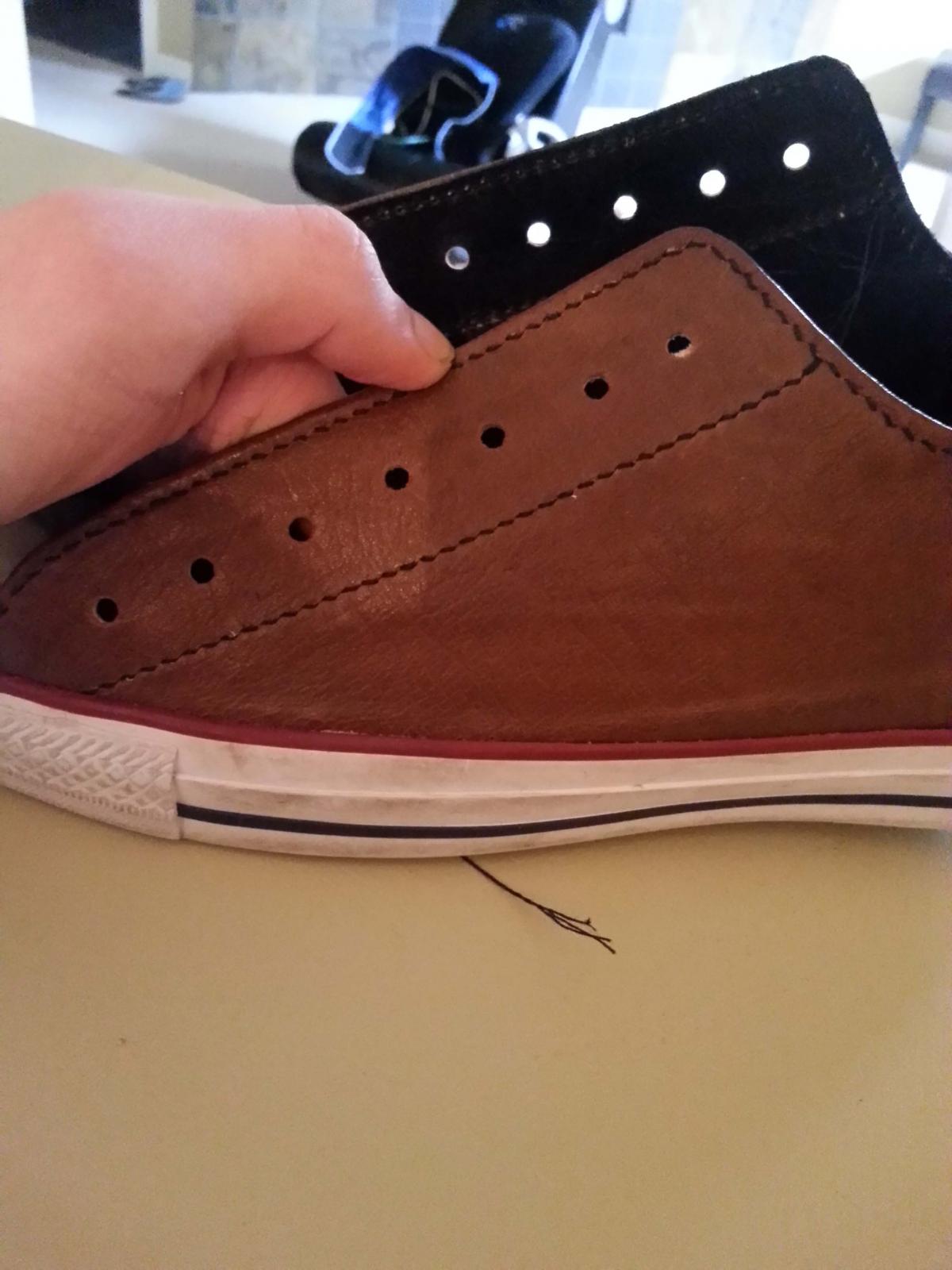

Members DavidL Posted April 29, 2014 Members Report Posted April 29, 2014 The black leather is stitched the same way with the same tools and thread as the first picture. I want the stitches to look like the second picture - less tension was used to set the thread in the leather because the thickness is 1mm. The sneaker is 3-4mm thick and had to be pull tighter and looks like 9 SPI. Is this a normal thing? The thicker the leather the smaller the stitch? Is this a technique issue or does sizing down to 5 SPI give me 7 SPI look? Quote

electrathon Posted May 9, 2014 Report Posted May 9, 2014 I have no direct answer, but want to comment that the stitching on the sneakers looks awesome. Quote

Tree Reaper Posted May 9, 2014 Report Posted May 9, 2014 Thicker leather will give you shorter spi. Quote
Members DavidL Posted May 9, 2014 Author Members Report Posted May 9, 2014 I have no direct answer, but want to comment that the stitching on the sneakers looks awesome. thank you for the kind words. I also forgot to mention that I wish my stitching looked as good as the one you don't like as much! I would be pretty happy with both of those results! Lots of hours got me these results so it wasn't like I was gifted with skill. Im also happy with the results (wanted a longer stitch), took me forever to realize that the type of leather I was stitching with before couldn't be stitched properly no matter what (tumbled vegtan and chrome tan). Other members have gotten good results on those types of leathers somehow. Thicker leather will give you shorter spi. Il try sizing up an spi. Quote
